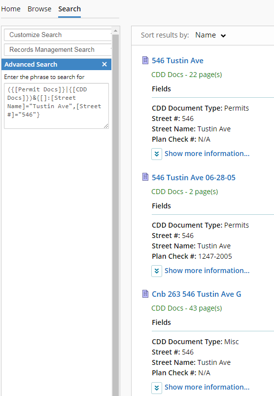

I was able to build a custom advance search that can search multiple templates using either weblink advance search or laserfiche client. But when i converted the search to URL enconding to create a link I'm not able to make it work. I noticed I have 1 element that added that there is no character for which is the pipe "|"
({[Permit Docs]}|{[CDD Docs]})&{[]:[Street Name]="Tustin Ave",[Street #]="546"}
http://ecms.newportbeachca.gov/Web/Search.aspx?dbid=0&searchcommand=%2B%7B%5BPermit%20Docs%5D%7D|%7B%5BCDD%20Docs%5D%7D%29&%7B%5B%5D%3A%5BStreet%20Name%5D%3D%22Tustin Ave%22%2C%5BStreet%20#%5D%3D%22546%22%7D
Use that URL I get "An unrecognized Character was encountered"

How did you encode the search syntax in the querystring? I found a helpful website that encoded the search syntax. I then pasted the encoded search string into the searchcommand portion of the querystring and it worked fine. The website I used was https://www.urlencoder.org/.
The complete encoded url that I used was...
http://ecms.newportbeachca.gov/Web/Search.aspx?dbid=0&searchcommand=%28%7B%5BPermit%20Docs%5D%7D%7C%7B%5BCDD%20Docs%5D%7D%29%26%7B%5B%5D%3A%5BStreet%20Name%5D%3D%22Tustin%20Ave%22%2C%5BStreet%20%23%5D%3D%22546%22%7D

Awesome! that solved the issue. Website does all the work for you.
I manually changed the characters based on laserfiche weblink whitepaper.
