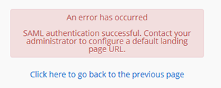

We have configured OKTA as our SAML provider and if I don't put in a Default Landing page I get the following error. (LFDS 10.3.1)
However if I enter one in the 'Default Landing Page' which is my STS formatted as
https://hostname.domain.com/LFDSSTS/ I get a blank page.
I was following another answer that mentioned if the SAML provider has a RelayState, that it is not needed.
Why is the page blank if I set it according to the message above, and how to fix it?

I updated the RelayState on OKTA to our Test Laserfiche environment and it is working now.
So I will setup a 2nd SAML SSO url for Prod and configure another identity provider for our Production Laserfiche environment.

Default RelayState is necessary if the user enters the Laserfiche SSO page (the STS) without a destination.
For example, if you navigate directly to the STS, there is no destination; on the other hand, if you click on a link to a form or document and then are redirected to the SSO page, you DO have a destination.
If end users are always signing in after attempting to access a Laserfiche application, then the RelayState default is really only useful to admins performing testing.
RelayState is information on the destination that is carried along during the SSO process, including during SAML authentication. as such, if you didn't have a destination when the SSO process started, the default RelayState will be added.
Note that LFDS-side configuration also has a default RelayState; I'm not sure how the Okta setting behaves, but setting them both is likely redundant. The primary use of the LFDS- side setting is to handle SAML providers that do not pass the RelayState through.
