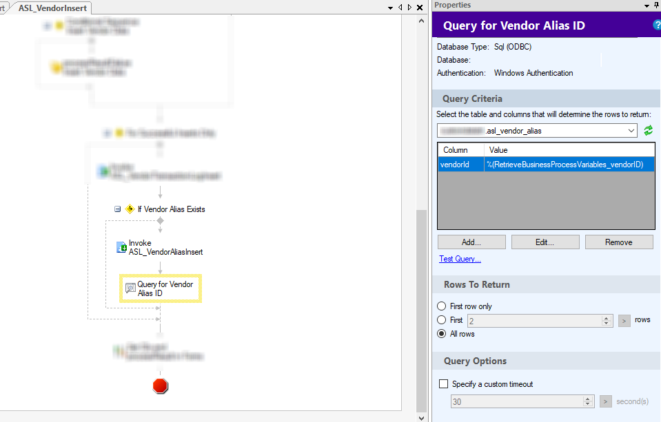

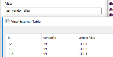

My "Invoke" below works fine.
As you can see, it successfully inserted 3 rows of data into an external table:

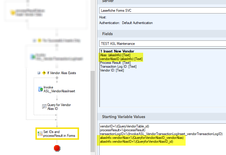

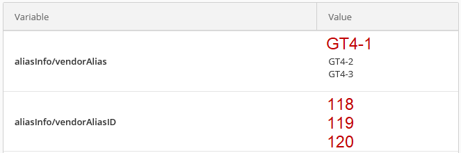

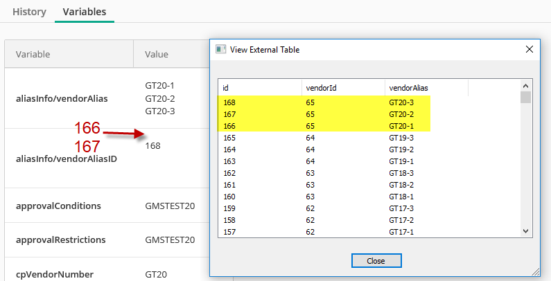

My issue is when I try to query the external table and send the data back to Laserfiche Forms ... it's missing Row #1 and all "id" info!
 When I test the query, it works. Do I need a "for each row" somewhere???

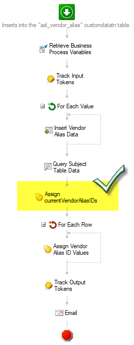

I do something similar although rather than push the query results directly as you are doing, I start out with a blank multivalue token, then underneath the query result I do a for each row and push the value into the token.  I then add the token to the form exactly how you do with the query results and it works fine.  I'd note that I didn't do it this way to overcome your issue, but because it was an existing workflow and I wanted to keep the values I was sending separate from those that previously existed.  Not sure if I would have encountered your situation had I pushed them directly as you did.

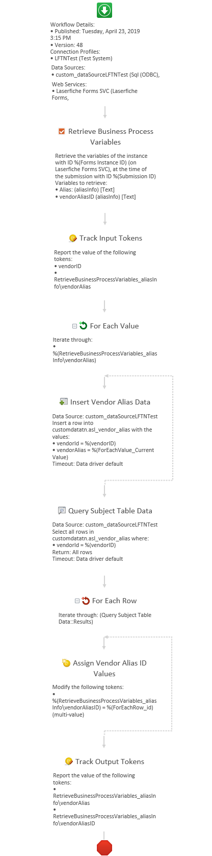

replied on April 23, 2019
OK, getting closer! I'm getting all three vendorAlias results and the last vendorAliasID:
Here's what my workflow looks like now:
