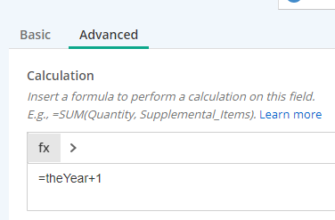

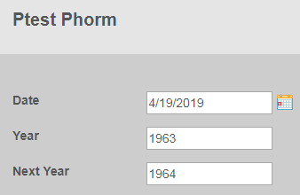

Actually, inserting a variable works well with other field types.  Here's an example of something I do occasionally.  A school year is passed in via the url and I use it to get last year dynamically.  (Previously they would have a form for each year...ugh)  I create a field that contains this
which results in...
I will hide that field and then be able to use it as a replacement value in headings, labels, paragraphs, etc.
I'm confident that this functionality works due to an event bound to the Year field.
Technically, probably not part of the dataset yet, but it is a much easier way to deal with field variables.  That is how I was hoping the custom html was going to work, but, alas, no go.

The key difference is that what you're showing above is a Function (Calculation) using a form variable (live), not a dataset variable (stored).
As an example, if you try to use the dataset variable in the Default Value, it would behave exactly the same as the custom HTML.
Functions on the other hand auto-execute built-in scripts when fields change using the active form's values. Dataset variables are static values from the database.
Hopefully that clarifies my other post a little bit more.
