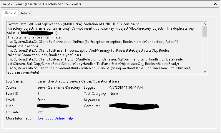

The error we've been getting is below.

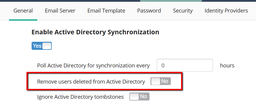

Deleting users from LFDS that have been deleted from AD is available as a setting in LFDS, under the general (added in 10.3):
If you turn that setting on, the users you delete in AD that are part of AD sync should be deleted from LFDS. As such, when users return (or a new employee joins with the same name), they will be added as a new user with a clean slate. Does that address your primary concern?
If you want to retain settings (security, attributes, etc.) across the LF suite when the users return, I would recommend disabling these users in AD instead of deleting them since you said this is a frequent occurrence.

As a final note, your error message screenshot is generated from the LFDS synchronization failure --- I was able to reproduce it when attempting AD sync in LFDS. That said, it does seem to me that a separate error noting that AD sync failed would be helpful.

Just to clarify, I know the error was generated was generated by the synchronization failure. I think the issue was that we didn't get any indication from LFDS that something was wrong so we did not know to check.

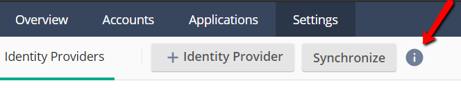

We have an item on our backlog for improving visibility of AD sync failure, though I don't have an ETA on when it will release.

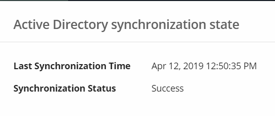

For now, we have a dialog where you can see the current status:
You can find it near the top of the Identity Providers page:
It seems like you'd prefer something that draws attention to itself, but I thought this might be helpful for now.

Thanks. That is how I determined there was a synchronization issue before getting the specific error from the event logs, but a notification would certainly be helpful as it is hard to know to check the status until we can narrow down the issue.
In our case, a user had a name change and Forms was still showing her old username. It look awhile to track that back to the AD sync issue, so some kind of email notification would definitely come in very handy in situations like that.
