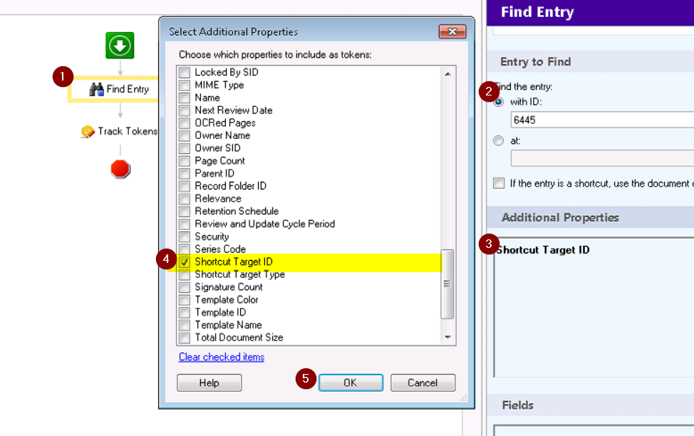

Hi Dominic,
Use a Find Entry activity and pass it the shortcut's entry ID. In the Additional Properties area, select Shortcut Target ID.

replied on April 10, 2019
Hi Rob,
Great bit of info there - appreciate it!
The problem I have though is that the Workflow runs when the shortcut is deleted, so the Find Entry activity returns no results.
I feel like the shortcuts used to have the same entry ID on older versions which meant I could just run a search (example below) to find the document however the shortcut ID is different.
{LF:Name="*", Type="D"} & {LF:ID=%(Entry ID)}
I may have to handle deletions using a Template field to capture the target ID before removing the shortcut. Curious to know if there is an alternative though.
