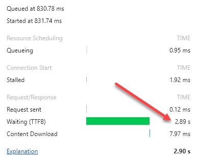

I have dug into the Network & Performance tab in Chrome. Powerful stuff.
I have looked at several of my forms and they all have a few seconds after the DOM content is loaded, and before the page is done loading:
I looked at the code from this call (type = document) and I didn't see any variable calls. It looked like it is the some infrastructure type stuff along with Braintree infrastructure type stuff.
This is the URL where this 2.89 seconds of wait is occurring.
https://OURSERVERNAME/Forms/form/avsubmission?RemoveHead=true&clientHandlesRedirect=true&routingResumeId=8b08aa1d-ef86-439e-9675-13855ea265ec&submissionId=&readonly=false&hideHeader=true
It seems to me that if this is something that Forms does for each process, we could throw some resources at it to speed it up????
I have spent some time with our VM admin and we threw another 2GB of RAM to see it impacted the load speeds, but it did not. I also performed this test from the Forms server itself, and still experienced similar lags. The delay actually went up a bit.
If this lag is coming from our Forms server, how can I speed up how the form loads? The server is not using all of its resources. Is this an IIS issue? Any recommended auditing tools out there?

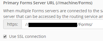

  3. I may have something for this item. This Forms server uses SSL:
    1. I cannot test with the localhost url. If I try the localhost url I get a certificate error message: There is a problem with this website's security certificate. Could the use of SSL slow down performance?

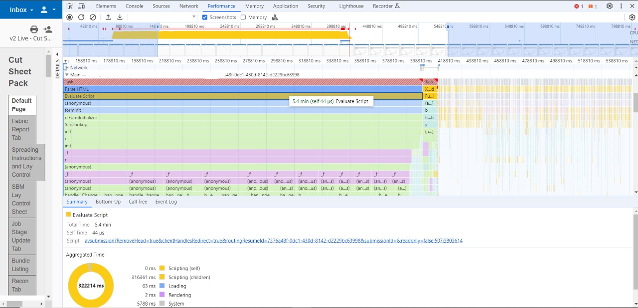

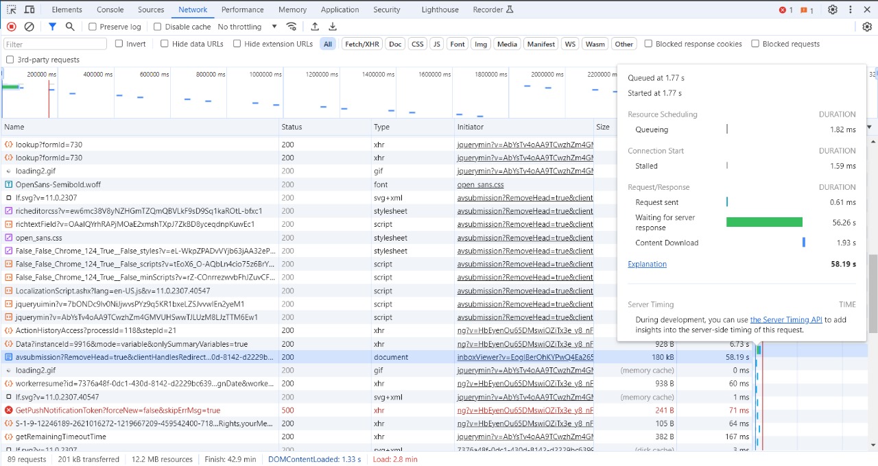

we are currently using Laserfiche Forms Professional Version 11.0.2307.40547, the form we currently experiencing issue is designed using classic form design and has about 25 lookup rules that get trigged with auto fill buttons. the issue at the moment is that the form opens and takes long to display the data which was from a previous submitting.
we have disabled lookups rule, but we are still getting the same results. The more data we have the more it takes to load from 30 sec some take up to 3, 5 minutes. Please advise if there's more information I can provide.

So you are experiencing slow performance when opening a user task? the "avsubmission" api is expected to return the form page in html so it will take some time to load, but it's abnormal to take 3-5 mins. Could you open a support case for this issue? In my experience, you may check if the form has complicated javascript that will recursively run, which also drag the load slow.
