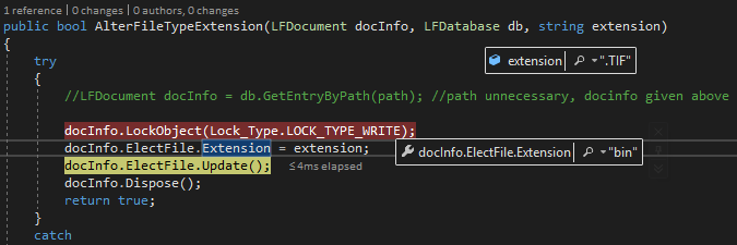

I'm looking to set the Extension for electronic documents after uploading them via the SDK. I already have an LFDocument handle of the object just uploaded. While this code compiles and runs, it is not actually changing the extension in LF.
docInfo.LockObject(Lock_Type.LOCK_TYPE_WRITE);
docInfo.ElectFile.Extension = extension;
docInfo.Update(); // Clears document handles.
docInfo.Dispose();
Thoughts on why this would not be updating the LFDocument's extension?

replied on April 5, 2019
Try calling docInfo.ElectFile.Update() after setting the extension on docInfo.ElectFile.
replied on April 8, 2019
We're not getting to that step yet; literally, the SET command is not setting the property. Even if I manually attempt to assert the value in the debugger, it is immediately reverted. I wonder if this is read-only, even though it has a SET function in the definition.
