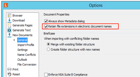

I noticed that the file extensions are missing for all files, when connect through webdav. A Google search has shown that there is an option (Retain file extension) that you can activate so that the file extensions are not deleted. (see screenshot)

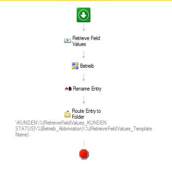

Our workflow is like this:
1. New Files gets dragged in to the Laserfiche Client.
2. We select a template for each file and fill in the required data.
3. As soon as a template is applied, the Workflow Module is activated.
The activated workflow can be seen in the screenshoot.

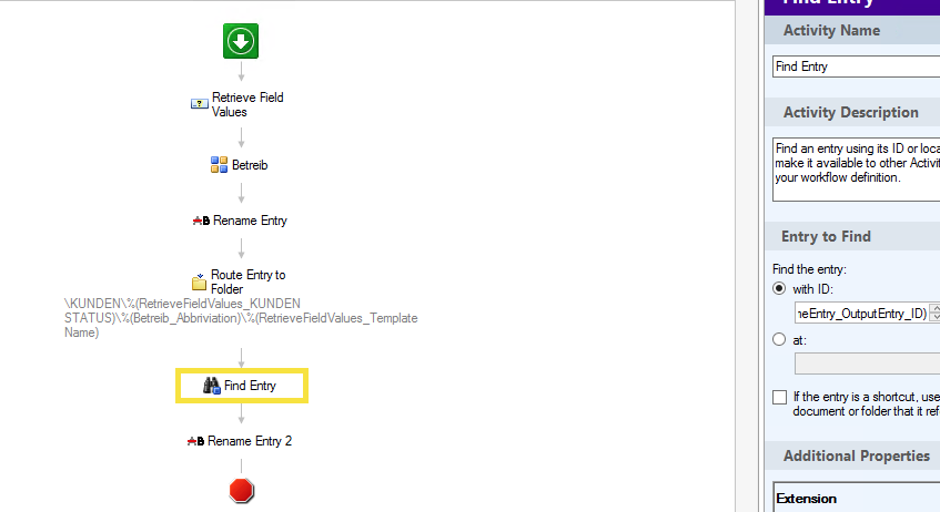

I need the file extension as a token. So that I can give it to the "Rename Entry" process.
Does anyone have a suggestion on how I can do this?
Best Regards Anish
replied on April 4, 2019
Client options do not apply to Workflow. You can run Find Entry on the document to get more properties about it including the extension. Then you can add the extension in your Rename Entry activity.
