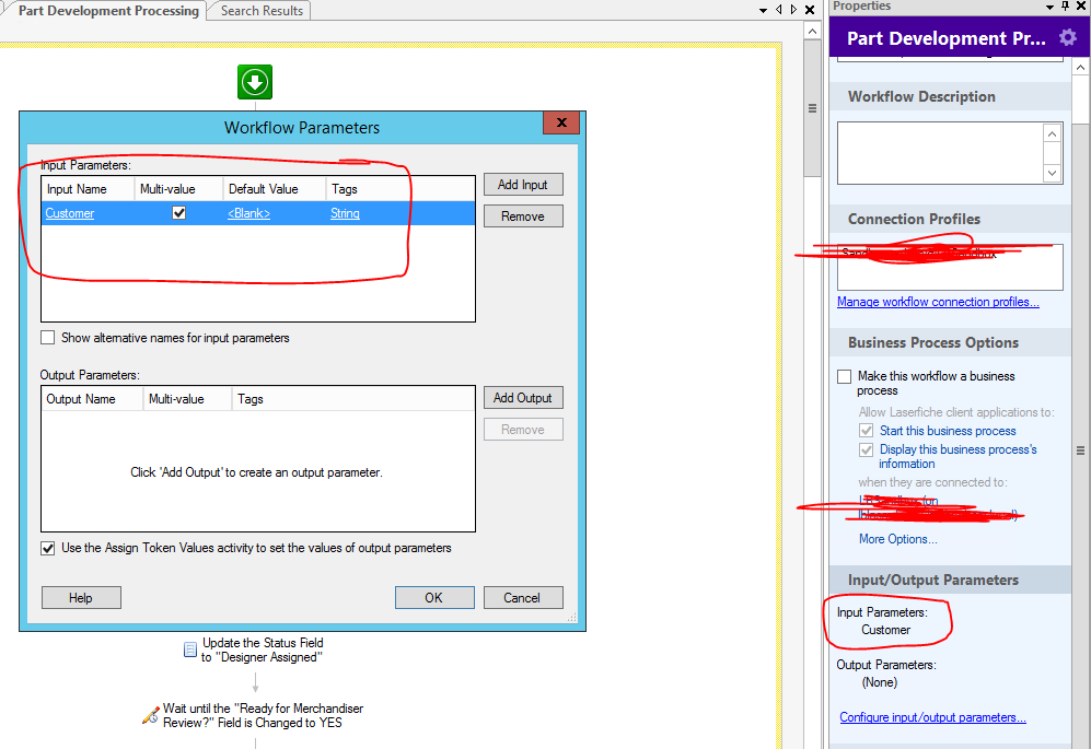

I have 2 Input Parameters set up in Workflow B for BP Instance ID and Submission ID:
In Workflow A I have assigned the Input Parameters the BP Instance ID token and Submission ID token (see screenshot 1 attached).

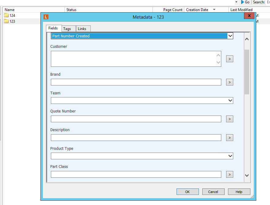

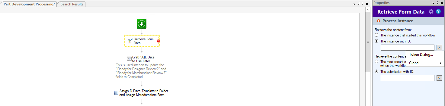

In Workflow B, I added a Retrieve Forms Variables activity but in the advanced properties I do not have the option to assign the Input Parameters from the other workflow to point it to that Instance or Submission ID (see screenshot 2 attached).

Workflow B shouldn't use the activity to retrieve business process variables, that's only for grabbing variables from a Forms process. You should use retrieve business process variables in workflow A to grab them from forms, then pass the values from WF A to WF B.

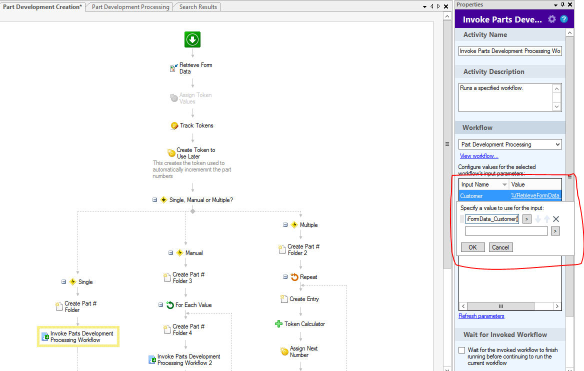

So this is what I was trying earlier with no luck. Sending screenshots to make sure I didn't miss anything.
In Workflow A, I assigned my Customer token from Forms into the input parameter (see screenshot "Workflow A - Invoke Workflow") I have attached a screenshot of my input parameter on WF B also

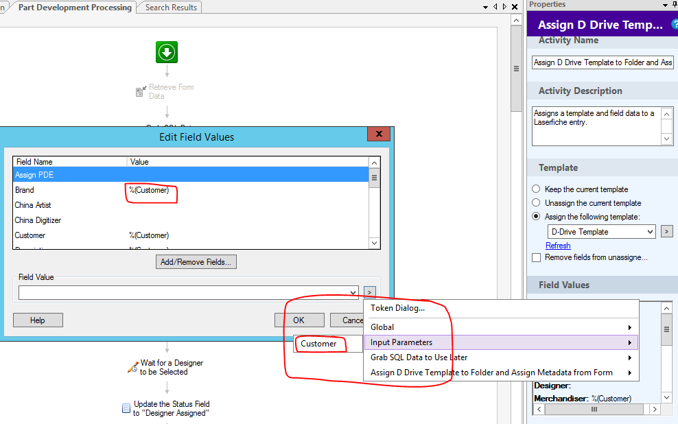

Then in my Assign Field Values activity, I am assigning the token that is passed through from WF A but it does not assign anything. If I track tokens, those tokens are blank as if nothing was ever passed over from WF A.

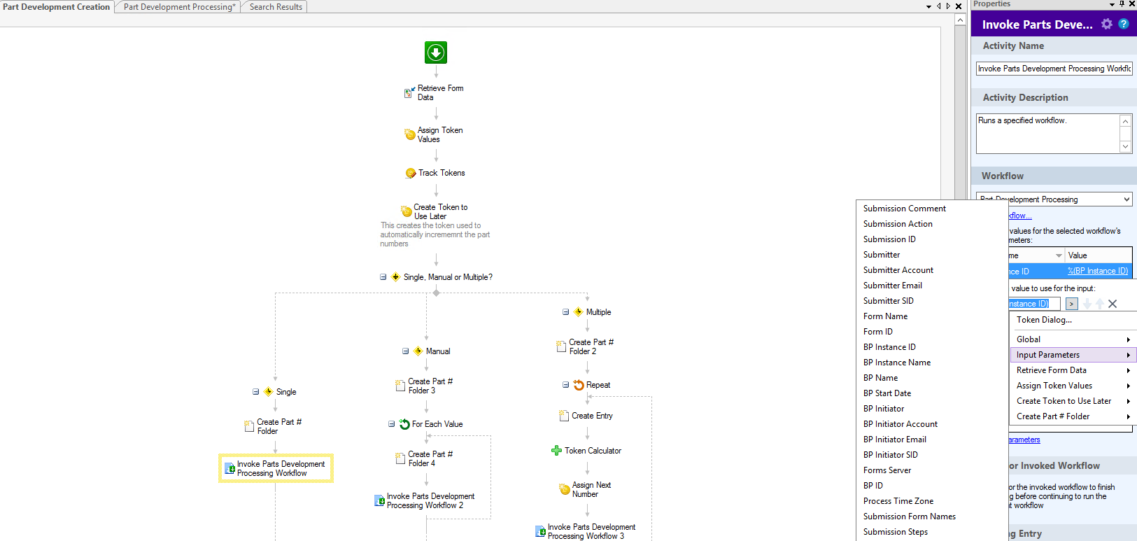

replied on April 3, 2019
Tokens are filtered by type in an attempt to make the list shorter and more useful to the user. If you open the Token Dialog you should have access to the full token list, including the input parameters.
