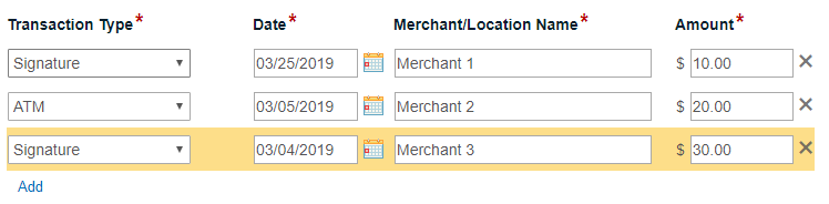

We have a process where the initiator lists a number of transactions that they want to dispute:

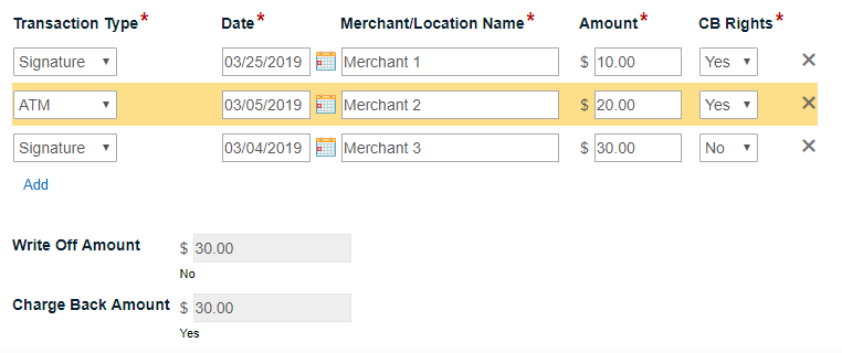

At the next step, we add a column to the table and the processor chooses yes or no for each transaction, indicating if we have charge back rights.  I then have two different currency fields summing the values depending on the result of the Yes/No question.
The Write Off Amount field uses this formula:
=SUMIF(Disputed_Transaction_Details.CB_Rights,"No",Disputed_Transaction_Details.Amount)
The Charge Back Amount field uses this formula:
=SUMIF(Disputed_Transaction_Details.CB_Rights,"Yes",Disputed_Transaction_Details.Amount)
