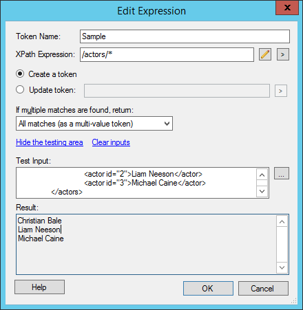

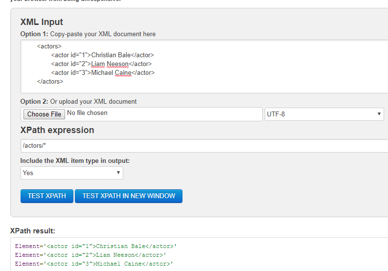

Is it possible to return the raw XML from a Read XML step in workflow?
For example, I've attached how the XPath tester returns online for a simple sample XML.  Then how it returns in the LF Workflow step.

replied on March 22, 2019 • Show version history
Read XML is going to give you the "interpreted" values.
If you want the raw XML received in the response then you want to look at the result Content token directly instead of opening it in a Read XML.
What the XPath tester is showing you is how it interpreted the XML because you selected the option to return the XML item type, but this is only meant for testing.
Workflow is giving you the actual values returned by XPath expressions.

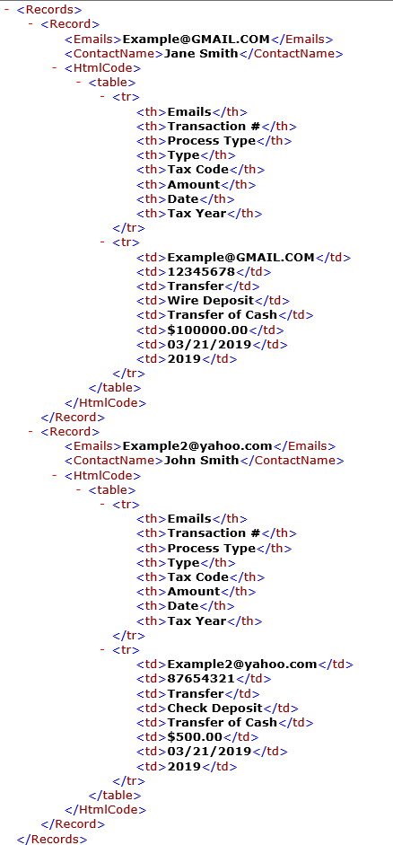

Attached is a sample XML which will hopefully give some additional insight into our use case.  I was hoping to pass this result into the Read XML step and create a multi value token where each element is the contents of /Records/Record/*.  In this case, a two element array with the raw Record XML.  Then I would use a For Each Value to iterate through the array, and another Read XML to parse the Emails tag, Contact Name and HtmlCode to send the email and include the information.  Rinse, repeat.
Let me know if you have any other thoughts.  Thanks again Jason.
