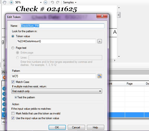

Trying take a pattern to take the 0 off the check number in QF
asked on March 14, 2019
I'm in need a better pattern for my QF session. I have one to pull the check number and to get 7 #'s but I only need the last 6 numbers. Here is the picture of the session. So I had changed it to a 6 but it took off the last number how do I get it to take off the first one?
replied on March 15, 2019 Show version history
OCR sometimes will read a 0 (Zero) as an O (Upper Case Oh) or an o (Lower Case Oh) so you could try a pattern like
[oO0](\d{6})
The pattern accepts o (Lower Case Oh),  O (Upper Case Oh), or 0 (Zero) before a 6 digit number.
replied on March 14, 2019 Show version history
Use the pattern \d(\d{6}) to remove the first digit. If you want to make sure the first digit being removed is a 0 you can use the pattern 0(\d{6}).
Hi Michael,
Thank you so much that helped. I used the first pattern the second one wasn't given me any numbers when I tested itsmileyyes Thank you for the fast response. Have a wonderful rest of your day.

Thank you I will looking into it. Now after I had put that updated pattern it won't read the checks after it reads the one. So I reached out to my IT to figure why the pattern broke another thing. But it does take off the 0 lol. Have a great day and weekend. smiley
