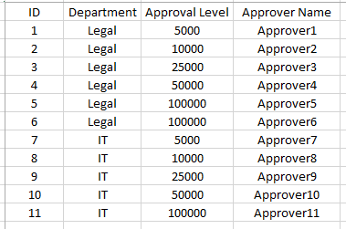

I have an approval process where we want the submitter to be able to select he approver based on dropdown, but only display users that have that approval level.
Submitter would select Dept from a drop down list, and fill in the approval amount field.
Once both fields have been entered, from a different dropdown, select the approver they want to send it to.  There can be multiple approvers at a particular level.
I could easily do this in Process Modeler with a logical gateway, but they want to select on the form.  I am familiar with the field lookup, but it only works for matches and does not have the ability for a comparison.

It sounds like you might want a stored procedure for that kind of logic. For example, instead of looking at the table directly, create a stored procedure that accepts the department and approval level as input values, then return a list of all values that match the department and have an approval level equal to or greater than the input.
