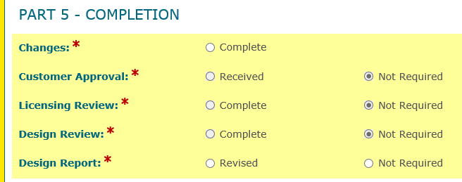

This works great with IE 11 (Ver. 11.590.17134.0, update Ver 11.0.110):

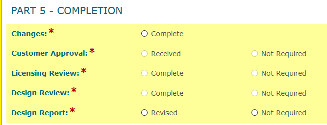

But doesn't seem to work with Firefox (60.2.2esr, 32-bit):
Is there a workaround?
