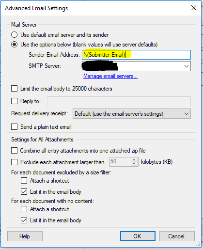

Justin,
We have a similar process where we use a Laserfiche Form to capture information and create a ticket in our help desk system.
Forms does not allow variables in the "from" field for an email task, however, you can get around this by using Workflow to send the email instead.
You have two options.
  1. Use a token value in the "Advanced" section of the email
  2. Use a Script activity to handle to send the email
With option 1, you have to manually type the email token. Although the "Sender Email Address" field doesn't have a token selector, it will accept tokens.
Option 2 requires a little bit of programming knowledge, but it provides a bit more flexibility, which we needed in our situation.
In either case, you'll need to make sure that you're workflow service/server is allowed to send "from" any address because some email server setups will block these messages as "spoofing" and not allow them through.
