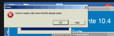

After I upgraded the customer WF module to 10.4, I ran the Configuration Manager to update the Server and Subscriber pieces.
Towards the end of the Server config, I received two error messages:
"Cannot Create a file when that File already exists"
"Manually rename or delete the file 'Laserfiche.Workflow.Service.exe.8.3.config'"
When you click OK to move past the message, you get the Configuration Completed Successfully message, which is a false message, as the server module still shows that you need to update it.
I did go ahead and delete the file the error message stated and re-ran the config and it completed successfully with no error.
Error Messages attached.
Jeff Curtis

Hi All,
Had similar issue here too, but ended up removing the file mentioned "Laserfiche.Workflow.Service.exe.83.config" in the Workflow directory under the Windows Structure and that fixed the issue.
Hope that helps,
Ziad

replied on February 15, 2019
Our upgrade experience was the same.
replied on May 22, 2019
I can confirm the same with upgrade from 10.2 to 10.4.
replied on June 7, 2019
Same experience here going from 10.3.1 to 10.4. Thanks for sharing this.
