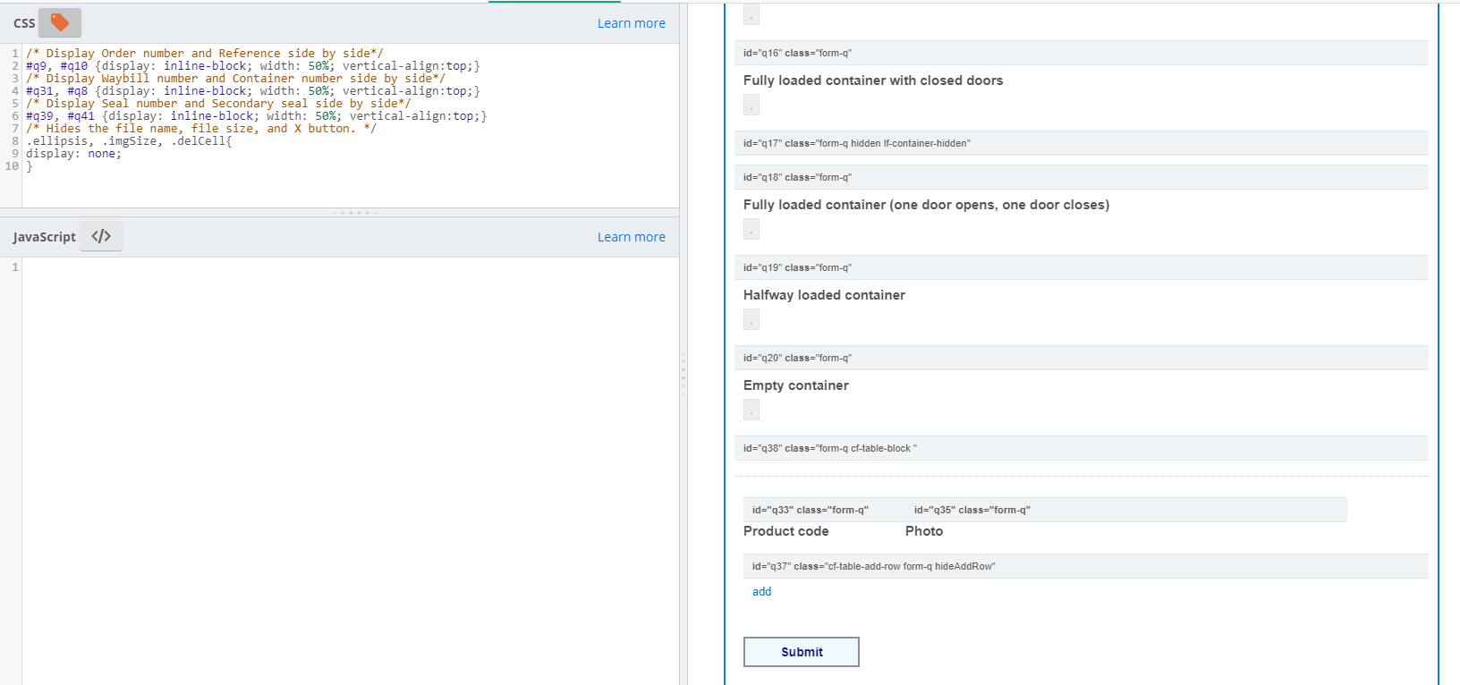

Thank you for this posting. I was looking for something like this too (not showing the file name) and it works great BUT it removes my "SUBMIT" button for some reason. I put this CSS code in my last form:
/* Hides the file name, file size, and X button. */
.ellipsis, .imgSize, .delCell{
display: none;
I still want to hide the file name but I need my SUBMIT button back. Any help would be appreciated! :)
Make sure that you do not have .Submit, button, input, or other selectors open before the additional CSS code.
Hello, I have exactly the same issue. When I directly paste the code in the CSS text area, the SUBMIT button disappears.
I am not really familiar with the CSS code so could you give me more details about the Michael's solution ? How can I check the code before the one I add ?
Thanks a lot
