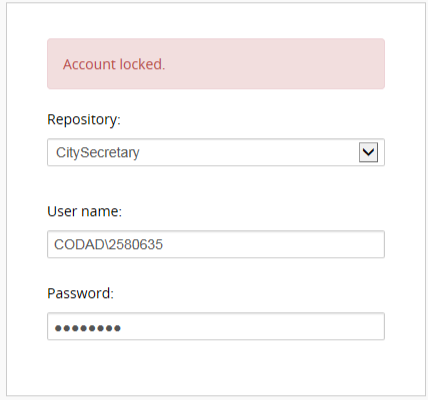

asked on February 13, 2019
New user getting Account Locked when attempting to access the repository.
I do not see anywhere in the Admin Console or elsewhere in Laserfiche about the user account being locked.
Thanks,
Lowell

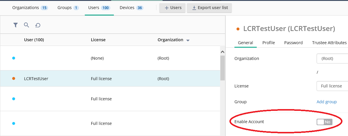

replied on February 13, 2019
Are you using LFDS for licensing?  If the account is not enabled you will get that error.
That worked!  Thank You!!!
replied on July 18, 2019
We use AD synchronization. What would cause that switch to get turned to No?
replied on July 19, 2019
In our case, we have an AD group that is used to grant users full licenses.  When the AD account is disabled for a Laserfiche user that is in the Laserfiche AD group, the Enable Account in LFDS is set to No.
