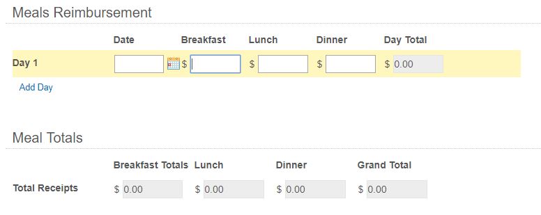

I am trying to get my Day Total to only calculate the totals for that day and is it possible to limit the day to $60.00?
The Name of the fields are BreakfastItems, LunchItems and DinnerItems.

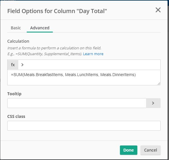

My code for the DayTotal is in the Day Total Formula.JPG.

Use the Index() and Row() functions.
=SUM( INDEX(Table.Col1,ROW()) , INDEX(Table.Col2,ROW()) , INDEX(Table.Col3,ROW()) )
INDEX takes in (column, row() ) which will give you the value at that column on the given row.
Using your variables, it should be something like
=SUM(INDEX(Meals.BreakfastItems,ROW()) , INDEX(Meals.LunchItems,ROW()) , INDEX(Meals.DinnerItems,ROW()))

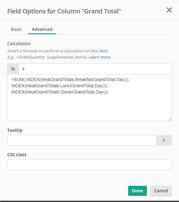

replied on February 13, 2019
I tried to put the formula in there, but I am not sure exactly how to use it.
Thank you for the help.
Don't use Day(), keep Row(), that's a function name so shouldn't be updated.
