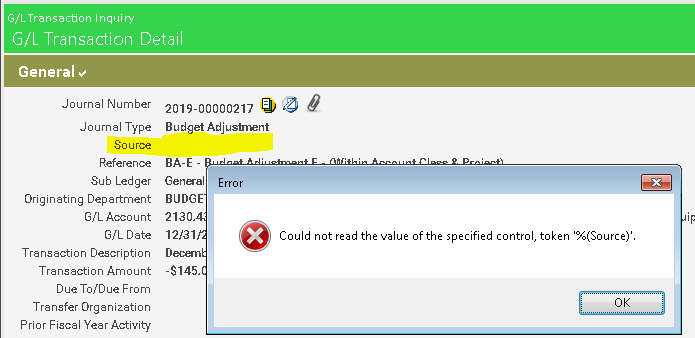

I have a couple of LF Connector profiles setup for our Budget Adjustments and they don't work when a token is set for a field that is blank.  Is there any way to configure Connector to accept blank fields?  This data is very useful to us when it is present (most of the time) and we prefer to keep it in the profiles if possible.  Thanks!

replied on February 13, 2019
Hello Qinmei,
Basically, I'm capturing fields on a page in our ERP.  When all captured fields contain a value, everything works fine.  However, when a captured field is blank, we get an error.  I'm attaching a snip of the error.  Thanks!
Hi Sarah,
When creating profile with defining the token for the field, can it test successfully with it?
