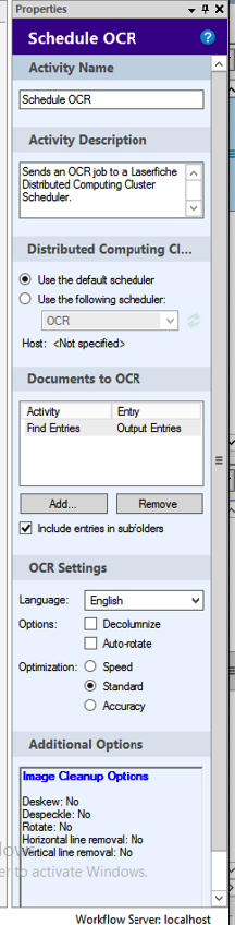

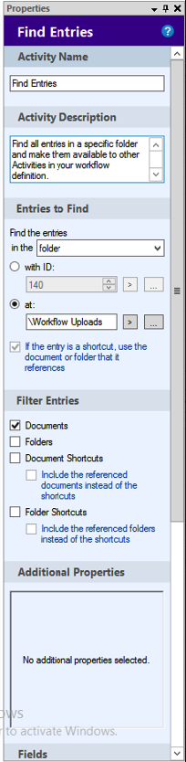

this is what i have setup in workflow
but it doesn't seem to work at all.

I added a for each entry module and put in the OCR inside it. Worked after I did that.

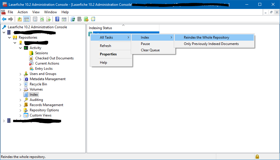

OCR is the process of extracting text from the image and creating the text layer.  This text layer is then used to index the words in the Search Catalog.  Only after the document has been indexed by the LFFTS is it text searchable.
There are several reason a document may be OCRed, but not Indexed.  The most common is that the Search Catalog sometimes will get corrupted and either go off-line or into read-only.  When you have this condition nothing new gets indexed and little if any text results are returned.  To fix this, delete the old Search Catalog and then create a new one and reindex the whole repository.
Another common reason can be if the LFFTS service has stopped.  Restart the service and then try to manually trigger the indexing of the document.

Sometimes it's as simple as just seeing if you can restart indexing. If that doesn't work, you can do the above.

no you have realllllly confused me. The documents ARE indexed but we still can't search and find document text. Why would that be??? I rcreated a new search catalog and reindexed the repo. all is completed. Why would I not be able to search the text on the document? Do I also have to use DCC and create OCR for each Doc?

Workflow does not perform the OCR on it's own. It needs DCC in order to do the work. So, you'll have to set up DCC, and then it will work.
