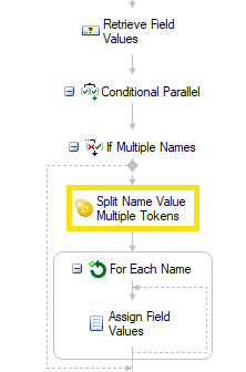

Then what happens is as the files come in, a simple workflow runs that Grabs the Metadata Fields, determines in the metadata fields have a "++" in them, if they do, then split them into multi fields. Picture of the workflow below.

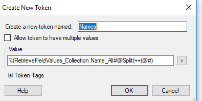

And I could index, but the problem is there could be so many names, etc, per field
Can anyone out there help and tell me why split function isn't working when trying to update the Multi Value field
Thanks
replied on February 5, 2019
You need to check the Allow token to have multiple values box, otherwise you'll only get the first value.
Haha, staring me RIGHT in the face and didn't even see it.
Thanks, that worked!
