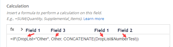

I have a table with 4 fields and a concatenate if then problem:
  • Field 1) which we will call A (a drop down pick choice)
  • Field 2) which we will call B (a number field) (which is hidden if the choice on A is picked as "Other"
  • Field 3) which we will call "Other" (a single line field that is hidden unless the choice on A is picked as "Other")
  • Field 4) Field #4 will always be hidden once testing is done and is used only to collect the final input to use elsewhere in the business process).
What I need is to have Field #4:
  1. combine the inputs from A&B for use elsewhere, OR
  2. if the input in A turns out to be picked as "Other", then I want Field #4 to show ONLY what was typed into the Other field.
I can't seem to get the concatenate formula to work.  Can you help me figure it out?

replied on February 4, 2019
Try:
=IF(Field1="Other", Field 4, CONCATENATE(Field1&Field2))
This works for me but I can't get a space in between the fields in the Concatenate.  I tried Field1&" "&Field2 but that didn't work.  Field1&"-"&Field2 worked and put a dash between but it does not like the space.

Hi Connie, based on your requirements above, it would look like this
=IF(Field1A="Other",Field3Other,CONCATENATE(Field1A,Field2B))
Steve
That's pretty much what I have, other than CONCATENATE(Field2B,Field1A)) because of how I want it to show up.
Tables do seem to be an issue.  I can't get it to work in a table either.
