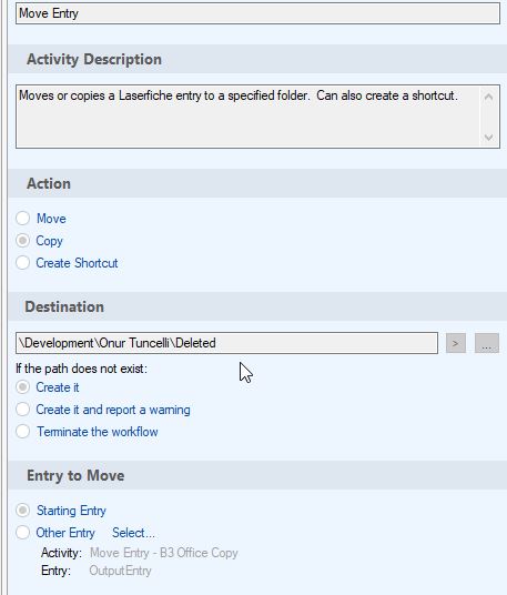

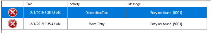

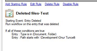

Let's say the user pressed the delete button and deleted a file. This should kick off a workflow that creates a copy of that file and sends it to an e-mail address. I tried to use Move Entry-Action (Copy)-Entry to move(starting entry) with starting rule Entry Deleted but I think laserfiche approaches these files in a different way and as soon as an entry is deleted it cant be found by the workflow. (See attached pics) Is there any way to do this?

Move Entry will not work on a deleted entry. You would need to restore the entry before moving it or emailing it out.

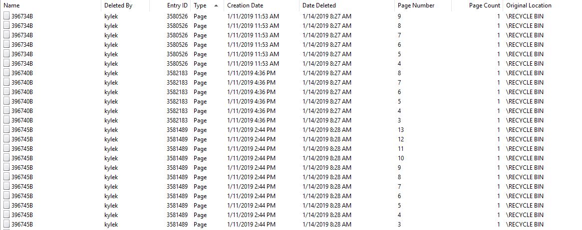

Ok, what would be the way to restore the entry from recycle bin with a workflow before we moving it or emailing it out? How I can configure the search syntax to make a search in recycle bin only? How can I search deleted pages rather than documents?
I am aware that the proposed solution is not the best one, its just the best we have come up with and I am open for any ideas. As I mentioned before, we don't want to extend 30 days of retention time. That is certain, so I am just trying to find a way around it. We already have a workflow that notifies certain users when a document or folder is manually deleted so we are already getting hundreds of emails every day. These e-mails have the date time, EntryID, UserID, file name and the path of the deleted file to help us to track down the situations if its needed. I would like to include the pages or the documents itself to these emails too. However, we cant track pages deleted because there is no type=page in configuration.
In the attached picture, you can see the pages deleted by the user from documents. Simply, I am trying to keep these longer than 30 days in case they would be needed in the future while avoiding to extend 30 days retention period.
