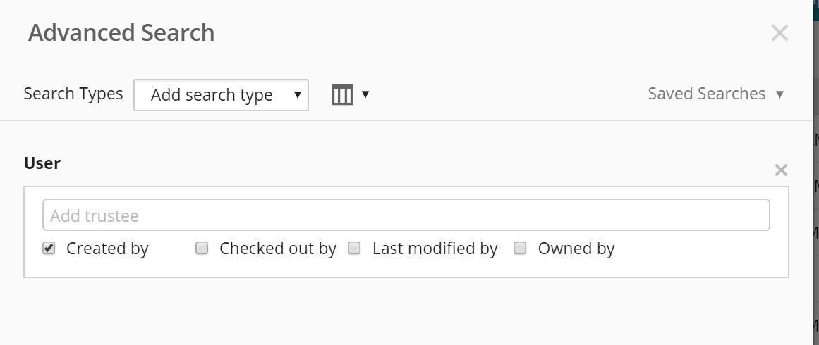

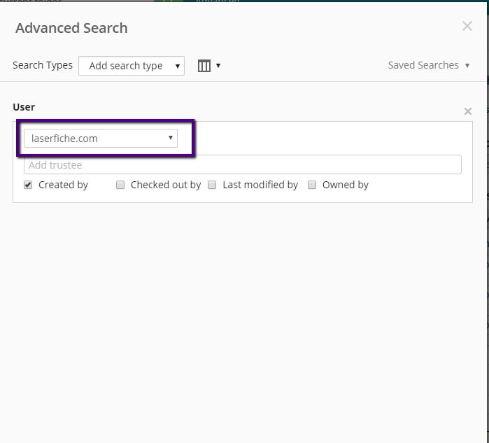

replied on January 30, 2019
Hey, Jeff,
So in the web client search syntax, is it just the alias that is incorrect, or is the domain itself also incorrect? In the Advanced Search dialog in the web client, could you double check if you have your appropriate domain selected from the dropdown?
Hello Alex,
I do not see that option, just add trustee:
Thanks,
Jeff
replied on January 31, 2019
I see. If there's only 1 domain, then the dropdown is hidden, so my original hunch may not be applicable for your organization.
Could you clarify some things about the web client syntax: {LF:Creator="domain\alias not correct format"}
So the domain is correct, but the username is not? Did the particular username get changed recently? Is it specific to this one user, or are all Windows users malformed?
Hello Alex,
The Domain format changes in the customer's user view when they go to look them up in the Web Client
When they type the domain that is used with the alias in the Thick Client, the Web Client User selection box throws a note - No Matches found.
If they try to type the alias of the user it appends that alias with a different variation of a domain.
