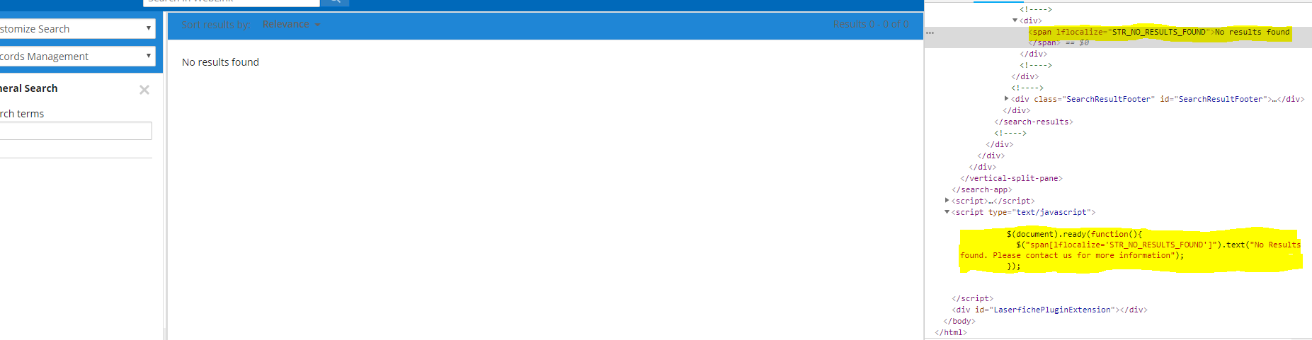

I am currently creating a Weblink page and have a requirement that when no results found appears (like below) that the wording needs to be changed to say "No Results found. Please contact us for more information"
Can anyone point me to the right place where i can customize this?

I added the script to the search.aspx file and it is still not working. I attended empower last week and in one of the weblink classes they mentioned something about having to put custom javascript inside a loop for it to appear but i haven't been able to find anything further on this, the slides from the class would be great (Developer 302: Advanced Weblink Configuration) but I don't think they have been made available yet.
