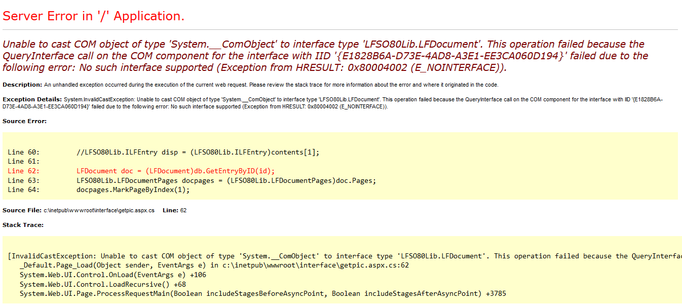

Hellow,
I am beginner in ASP.Net and am working with Laserfiche SDK, But when trying to access the LFDocument Object I get the following Error.
Unable to cast COM object of type 'System.__ComObject' to interface type 'LFSO80Lib.LFDocument'. This operation failed because the QueryInterface call on the COM component for the interface with IID '{E1828B6A-D73E-4AD8-A3E1-EE3CA060D194}' failed due to the following error: No such interface supported (Exception from HRESULT: 0x80004002 (E_NOINTERFACE)).
event viewer does not show anything regarding this error. If I dont use that Object everything works fine but I need to get the documents so I must use that.
here is my sample code

Any help please..
replied on January 24, 2019
You may want to first get it as an ILFEntry and check the entry type.  If entry type = document, get it as an LFDocument object.

Bert is probably right about the root cause.  If this is a new project you would be better off using the .Net SDK instead of the COM one.  One benefit is better error messages, which in this situation would be something like "Can't cast instance of FolderInfo to type DocumentInfo".
