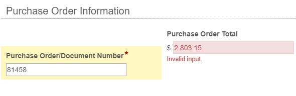

We have a process where on a Form, a purchase order total is pulled when a user keys in a purchase order number.
The field on the form is of course a currency field.  I have tired it with and without the thousands delimiter
When the amount is pulled over from the database, Forms is treating the comma as a decimal?
Data is stored as a varchar in SQL.
This seems to happen on any amount with a comma in it.  Wondering why the form doesn't take the comma as is, especially since I am using the delimiter.

I'd say the problem is that the data type is varchar; this seems related to language/region-based functionality because in some places the period and comma are used in reverse for numeric values.
For example,
US - $1,000.00
Brazil - $1.000,00
Typically, numeric values are not stored with a "thousands" delimiter, so it may just be that both the period and comma are viewed as a decimal separator with a string/varchar value.
As a workaround, you could attach the lookup to a hidden Single Line field, then in your Currency Field use a function to automatically copy the value. Like so,
=VALUE(LookupField)
That way, you can pull the varchar value as-is and the value function will clean it up before putting it into the currency field (just replace LookupField with the variable name for your hidden field).

It may be a bug, or something with the configuration, but I'd say it is best to avoid connecting a string/varchar lookup directly to a numeric or currency field anyway.
Another option would be to create a view in SQL that sanitizes the values on the database side, then you don't have to worry about what is being sent to Forms.
For example,
SELECT CAST(REPLACE([currency],',','') AS decimal(18,2)) AS [amount]
FROM [myTable]
However, you still run the risk of the view breaking if someone slipped a non-numeric value into that column.
