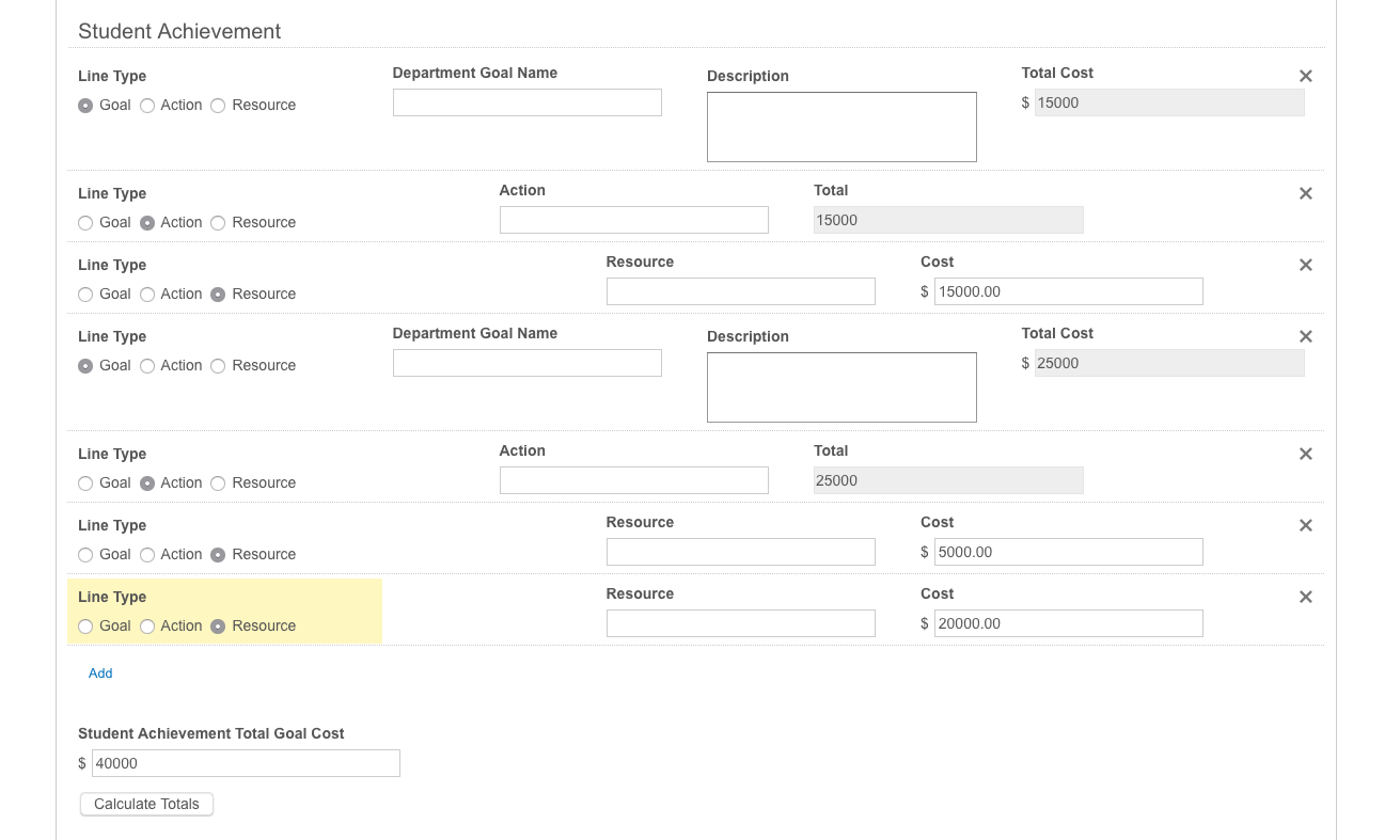

I'm wondering if this is possible. I have a collection with radio buttons that determine if the row is a goal, action, or resource. If it's a resource then it gets added to the action above it. If it's an action that get's added to the goal total. So for example, a goal can have several actions and an action can have several resources. Is there a way using the built in formulas in forms to check the radio button and if it's a resource add it to the action above it? And then add all the actions to the goal above it? Afterwards have all the goal totals go in a field outside the collection.
I have this working with javascript but I'd prefer doing it through the formulas.

Each total has it's own field and class. Can I determine if the row needs to be used in the calculation based on the radio button value? Would an IF statement work for that? The way I'm envisioning it in my head is this
IF RadioButtonValue = 2, get Cost and add to previous row with RadioButtonValue = 1
Then for all RadioButtonValue = 1 add to previous row that RadioButtonValue = 0

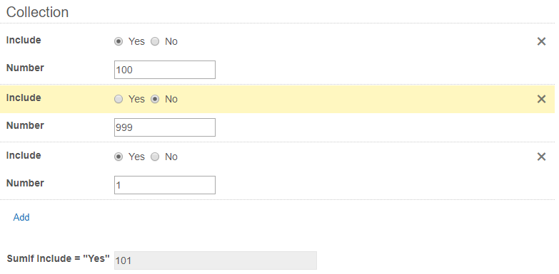

SUMIF can check a column value, and if a match is found, add the total for another column in the matched row.
For example,
=SUMIF(Collection.Include,"Yes",Collection.Value)
Gives the following results
You can see here that it adds rows 1 and 3, but excludes row 2 because No is selected, giving you a total of 101.

So for each row the first thing that happens is the radio button gets selected. This determines which fields show up. If it's a goal you get the name, description and total cost. When an action is selected you get action and total and when you select resource you get resource and cost.
For each action row the math is adding all the resource costs below it and putting that value into the total field.
For each goal row the math is adding all the action totals below it and putting the value into the total cost field.
Each goal can have multiple actions and each action can have multiple resources associated with it.
