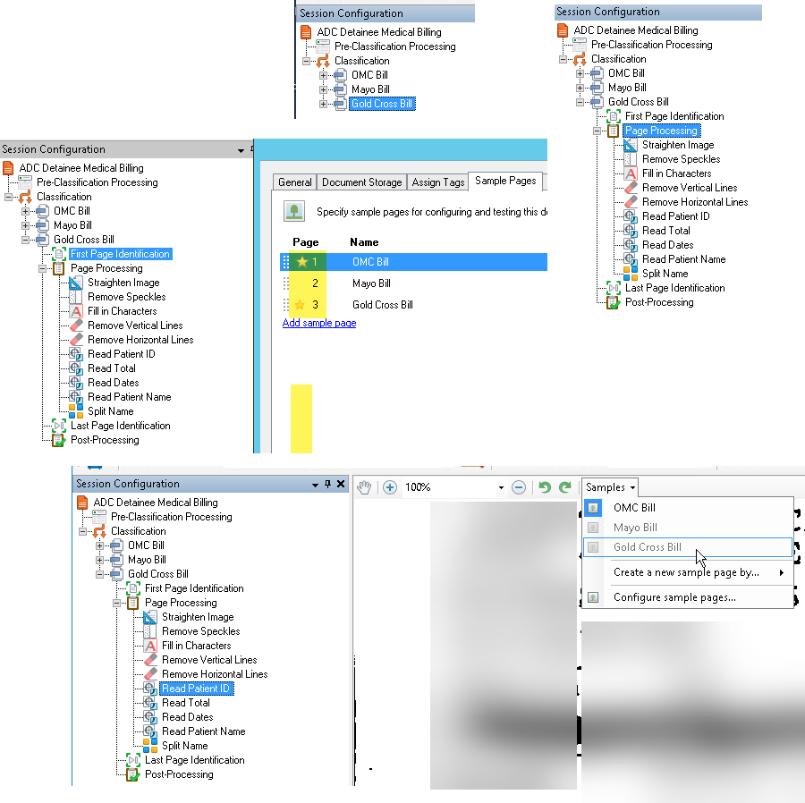

I am having issues with sample pages and hope someone can point me in the right direction.
Version 10.3.0.81
I am creating a session that will have 3 documents classes.  I have uploaded 3 different sample pages.
At the main document class level, I can set each class to a different sample page.
At the First Page Identification level I can only temporarily change the sample page. I have even gone in and changed the default page.  Once I save the session and look at the level again it revert back to the first page I uploaded and shows that both pages are now default.
At the Page Processing level I can only temporarily change the sample page.  It stays on the page I choose as long as I am working in the class. As soon as I move to a different class and move back, the sample page goes back to the first one I uploaded.
At the Zone OCR activities under Page Processing I can't change it at all. In fact all pages I uploaded after the first page are greyed out and I can't choose them.  Even if I get the page processing level to go to the correct sample page, the Zone OCR activities won't change off the first page I uploaded.
I would appreciate any help I can get on getting different sample pages to stick.  I am sorting invoices with this session and the invoice setups are different based on vendor.  It makes it difficult to set OCR zones when I can't use a sample page.
Thanks.

The sample pages are filtered based on which pages your process is set to run on. In this case, your Zone OCR is probably only set to page 1.

Thanks.  I didn't realize that is how it chooses what sample page to look at.  Sounds like my only way around this is to switch which sample page is "page 1" long enough to draw my fields.

Yes, it's trying to default to the right page for configuring the process. Another way would be to temporarily switch the process to the page you want to test on.
