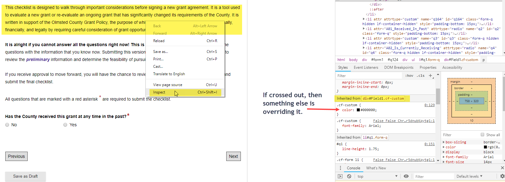

2. Have you tried to inspect it to see if something is overriding it?  I work mostly from chrome so the following instructions are from chrome.
a) pull up a preview of your form.
b) go to one of the html fields and right-click your mouse on it.
c) from the menu choose "Inspect".
d) (should open a window to the side) scroll down the box (see image) until you find the spot that says it is inherited from the custom field.
e) if it has lines drawn through the font, then something above it is overriding your css.
