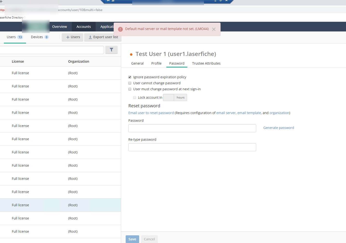

Hello all. We're unable to trigger password reset emails from LFDS on our server. When we click the link under 'Password' in LFDS for a particular user, we get the error 'Default mail server or mail template not set (LMO44)'.

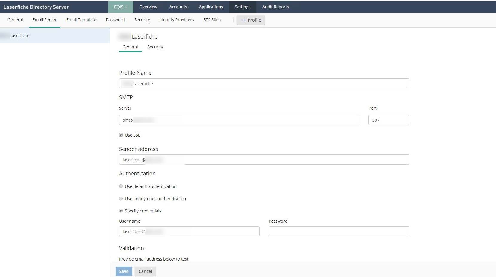

Here are two screenshots. We've configured a server and can send test emails through it. We also have a template configured, but how do we set the defaults for use with the user password resets?
Here are two screenshots. Thank you as always for your help.

Hi Chad,
The default email server and template for an organization can be set under the desired organization's "Settings" tab.
