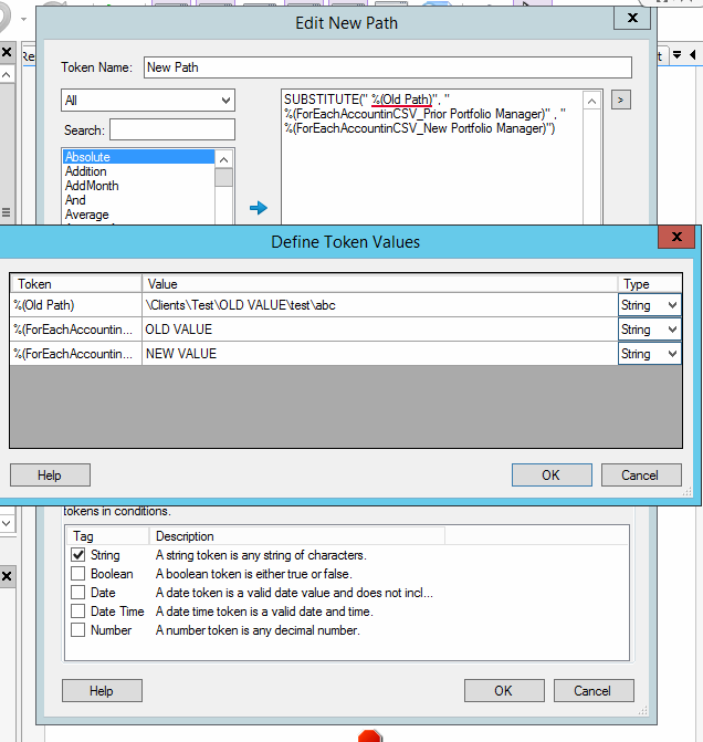

It's the double quotes. They make the token a literal value. You also seem to have spaces in front of each token inside the double quotes.
replied on January 16, 2019
Can we get screenshots of how your activity is set up, please?

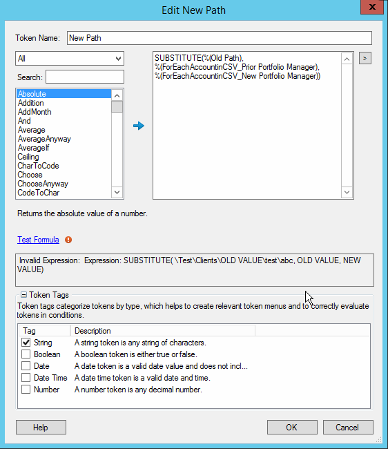

Here is a screenshot of how it is set up and the result.

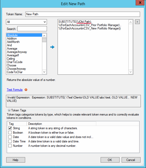

I removed the quotes and now it says it's invalid. Also, I noticed those spaces in front of each token before, but when I removed them and click OK it put them back.
That probably has to do with where you create the token in this workflow. Notice that it's still marked as invalid even when it's in quotes.
Even with the token valid, it's the same behavior.

Without the quotes, it does appear to be working when I run the workflow even though when I try to test it says it's invalid.
