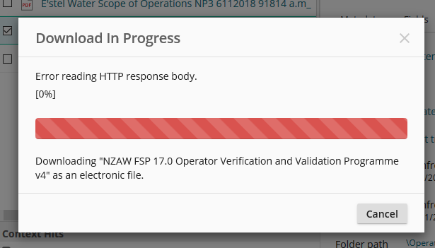

A client of mine is having an issue where they receive the error 'Error Reading HTTP Response Body' when attempting to Edit/View an electronic document.
I've noticed this tends to happen when the document is checked out, worked on, and then checked back in the first time. After it is checked back in, they can no longer access it due to the error. Looking at the raw document in the desktop client shows there doesn't appear to be anything wrong, so I'm at a bit of a loss as to what's going on.
They're currently running 10.3.1 - I have seen this error in all browsers and the latest versions of them.
I've attached a screenshot of what I see when I try to open a document that has been checked back into the repository. I have all administrative rights.
This occurs when you right click on the document in the web client, select 'Open' and then 'Electronic Document'. It checks the file out, but then cancels the download due to the error.

This error typically refers to the connection between the web client and the Laserfiche server.  Is there some kind of scanning firewall that might be blocking the download?

Ok I think I have discovered the issue.
It appears to occur during the import process relating to the option 'Generate searchable text when importing documents'. With this ticked/enabled, any documents with externally pasted images inside a Word document header causes a corruption during the import process.
The document appears to import fine and check it self in, however you can no longer download/edit the document as per the original error.
Unticking/disabling 'Generate searchable text when importing documents' and importing the same problematic document works fine and users can download without error.
Is this a bug I should be reporting? What is the process to do so? In any case, I now have a customer who has imported a large number of documents that they're not overly interested in importing again.
