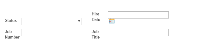

I have two items on one line. The first is a simple drop-down field and the second one is a date field. I am not able to make the date field show the calendar button on the same line. It will show below the date field every time. Does anyone have a CSS solution for this? Already using .TwoPerLine and tried some width adjustments to see if that would work, no such luck. Any help is appreciated.

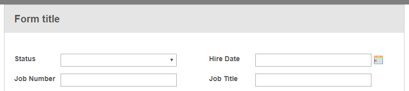

The following will put them side-by-side if you add TwoPerLine as a custom class to all four fields.
.TwoPerLine {
  display: inline-block;
  width: 50%;
Then you just need to adjust the label and field widths, for example
/* Increase your field widths */
.TwoPerLine input,
.TwoPerLine select {
  width:90%;
  /* do not exceed 90 because you need room for the date picker icon */
/* Fit your label */
.TwoPerLine .cf-label {
    width: 25% !important;
/* May or may not be needed */
.TwoPerLine .cf-field {
    width: 70% !important;
And you get
