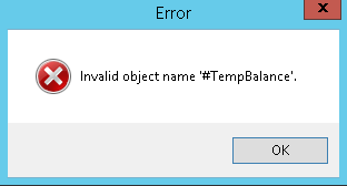

I just want to do a simple select to a temp table where data has been built.
Is workflow not able to query and return data from a temp table in SQL?

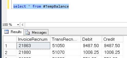

SELECT *
FROM #TempBalance
When the Query is executed in SSMS it works just fine.

I think what Miruna is getting at is that MSSQL temp tables are only visible within the session that created them, so for you to be able to successfully interact with a temp table in SSMS you must have created that table earlier in your SSMS session.  I think that restriction on temp tables is going to make them difficult to take advantage of from Workflow, unless you can guarantee that the query is run in the same connection that created the table.

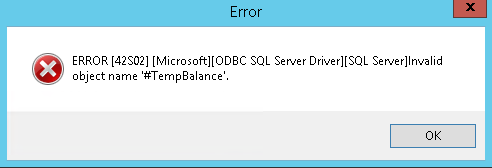

Laserfiche does not do anything here, it just passes the query to the driver. The error comes from the driver.
I can't see the whole query, but maybe you have a typo on the definition? Also, different data activities make their own connections to the data source, so if you make the table in one activity and try to use it on another, that could be the cause as well.

I have even tested the same query with Direct and not ODBC to verify and the results are the same.

Have you tried specifying the database? Usually my temp tables are in tempdb not the database associated with the data source configuration.
Try adding USE [tempdb] before the select, but it also might depend on what is creating the temp table in the first place.
Like Miruna said, each activity is a separate connection. When you're in SSMS you're more likely to be using the same connection, and probably a different user account, to test.
replied on January 8, 2019
Right, temp tables are not accessible after the fact. So if you make it in SSMS, you can't query it from WF. You can't even query from another session of SSMS logged in as the same user. You have to make it and query within the same session, be it SSMS, a single WF activity or some other SQL client.
