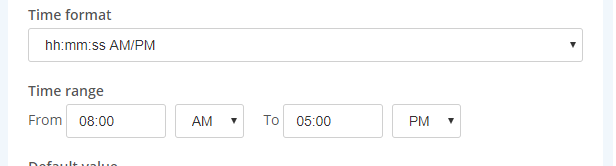

There is an option on the time layout to configure ranges:

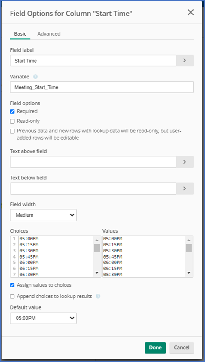

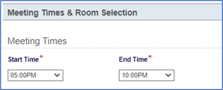

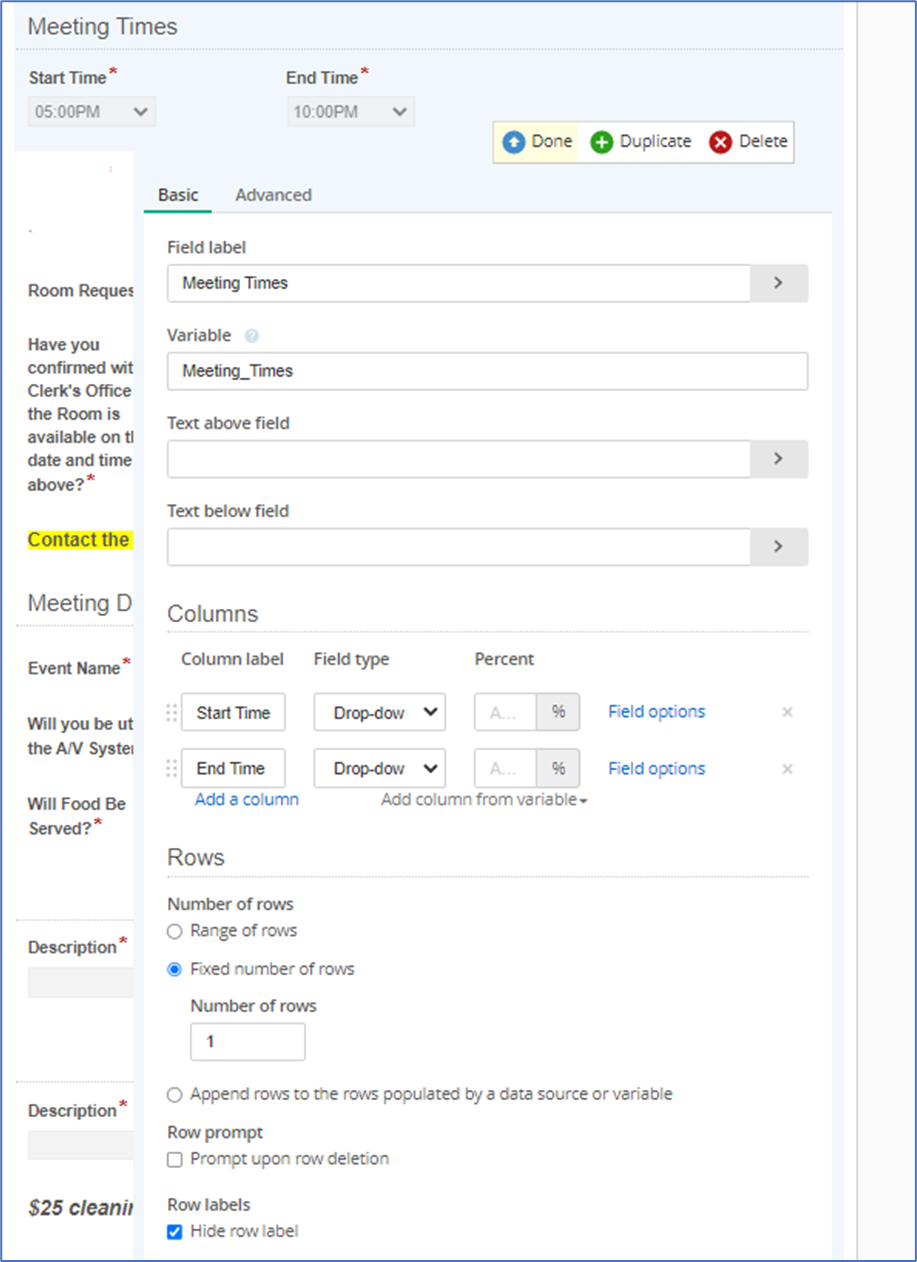

I found a low tech alternative that worked for my room reservation form.  Set up a table with Start Time and End Time dropdown list columns.
Set up the allowable times as choices in the drop downs.
Not good for use cases needing time calculations, but I did not need that for this form, so it was a good workaround for me.
Hope this helps someone along the way.

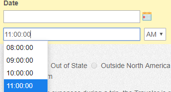

With the standalone Time field, it will only show 8-11 when AM is selected, then if you change it to PM it would give you the 12-5 option.
However, the time field included in the Date field when "Show Time" is enabled seems to lack the event handler responsible for facilitating that behavior.
I'm not sure this is necessarily a bug since the Date + Time field doesn't include support for restricted time range in the configuration yet, but it definitely complicates things.

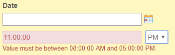

This is behaving like a bug. I can put in the min & max with javaScript:
  $('#DateTimeField453').attr('max',"05:00:00 PM");
  $('#DateTimeField453').attr('min',"08:00:00 AM");
^ I toyed with changing the format to 08:00:00 to 17:00:00 and that didn't help.
The min max validation works in the field:
However, the issue that Ken is referring to is that the dropdown list of hours to choose from changes to only 08:00:00 to 11:00:00 only.
You can manually type in different hours and they get validated the same as the image above. The issue is the dropdown. The HTML does not have a list of <options> to edit with javaScript.
