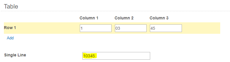

=CONCATENATE(Table.Column_1,Table.Column_2,Table.Column_3)
However, it looks like you're using a table or collection since you have the Variable.Field format, and that means you should be using the Index function.
If the fourth field is part of the same table, you can use ROW() and it will automatically use the row value of the field itself, or you can just put in a 1 if you only need one row.
INDEX(Table.Column,ROW())
or
INDEX(Table.Column,1)
Another thing to try is an IF condition that evaluates length, so IF the length of Field 2 = 1, you add the leading 0 back. The problem you're having now is that it is always adding the extra 0.
Try something like the following:
=CONCATENATE(INDEX(Table.Column_1,1),IF(LEN(INDEX(Table.Column_2,1))=1,"0",""),INDEX(Table.Column_2,1),INDEX(Table.Column_3,1))
