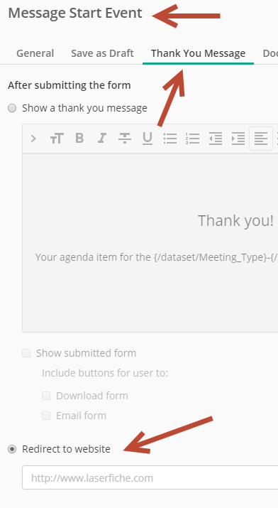

How do the users cancel a form for you? You can redirect users on the 'Thank You' page to a different website.

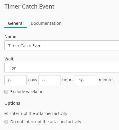

In the process designer, place a timer on the above cancal step. Add a terminate event onto the timer. This will kill this process after x minutes, whatever you define.

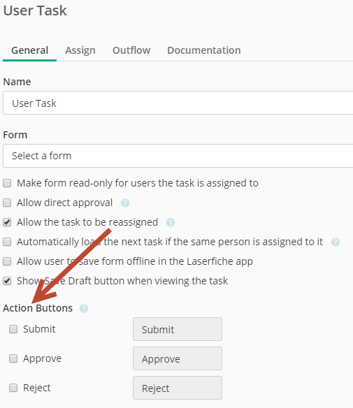

You can edit the buttons used in the Process Diagram when you add a User task and then go to its properties.

Hi Blia,
I think you are right, Chris' example would work for user tasks, but not a message start event. Your approach sounds valid though. The Thank You page only appears when the form is actually submitted. If you added your own cancel button, you would need to have that link to your own custom cancel page.
