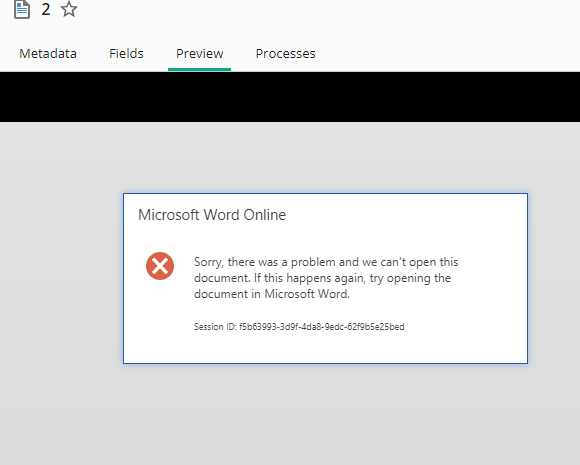

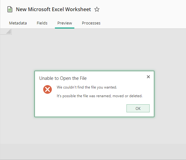

We are trying to apply integration between Web Client and Office Online Server to view and edit office documents online from WebAccess.
We installed and configured Office Online Server based on Microsoft's deployment guide in https://docs.microsoft.com/en-us/officeonlineserver/deploy-office-online-server and verified that Office Online Server is installed and configured correctly by accessing the discovery URL http://servername/hosting/discovery which shows XML contents as expected.
But in web client it shows error when view or edit office documents.
We even applied the workaround on https://support.laserfiche.com/kb/1013901/a-sorry-there-was-a-problem-and-we-cant-open-this-document-error-occurs-when-viewing-a-microsoft-office-document-within-web-client-10-2-1-update-2-with-the-office-web-apps-server-option  but still same issue.
Any advice for what could be the issue in this case? Appreciate your help.
