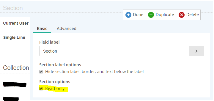

The issue you're seeing is that the User Task checkbox for making the form read-only has different behavior compared to setting read-only on a field/section on the form.
When using the user task setting, it "flattens" the form content so there are no HTML inputs anymore and the lookups will not work.
You could create a copy of the form (unless you're already using a separate form) and set all of the sections to read-only (so you don't have to do it for each individual field), then use the "read-only" form in that user task.

I ended up setting up some javascript to apply "readonly" and "disabled" on the fields I did not want the user to adjust as well as update the fields via workflow with the "Set Business Process Variables" tool.
