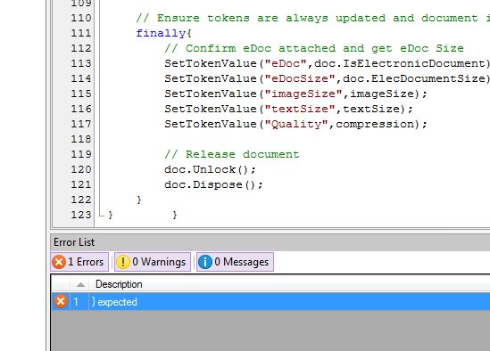

Jason,  I may be wanting to borrow that SDK Script...  but can't figure out how to get it to work.  This is my very first SDK script to use in conjunction with a Laserfiche workflow, it spits out a bunch of syntax errors, and not as easy as copy and paste into the SDK Script activity.  Any pointers for getting it to work?
EDIT: forgot to switch it from vb to cs...    but still have an error, thoughts?
replied on May 3, 2019
Looks like you have some extra brackets based on the screenshot. If you're copying and pasting into something with existing code, only copy lines 3-104.
replied on May 3, 2019 • Show version history
Shoot, deleting one of those brackets created another error, lol
I don't think you have extras at the end, you have more at the top than you do at the bottom. It's really hard to say exactly since I can't see the entire code block.

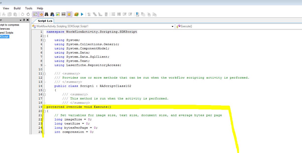

Alright, yes I am a beginner, so thanks for your patience! When I opened up the script, I copy pasted it where the highlighting starts....
If that's where you copied it, then you should have 4 end brackets in total
1 - closes the Finally
2 - closes the void
3 - closes the class
4 - closes the namespace
You might also want to indent the pasted code so that it shows the correct hierarchy.
You'll also need to add
  • Reference for Laserfiche.DocumentServices
  • using Laserfiche.DocumentServices
  • using System.IO
Bingo,  no errors :) Time for testing! Thank you very much!
