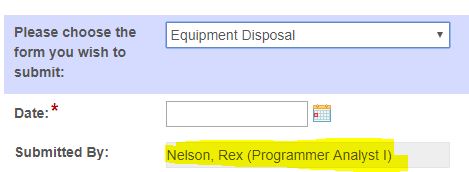

So I have a field on my form that displays the current user, it is read only.
It works correctly while filling the form out.

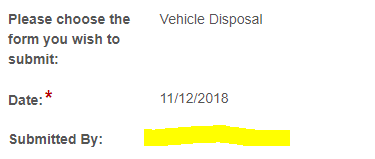

But every step after I submit, the current user is blank. Even when saved to the repository.

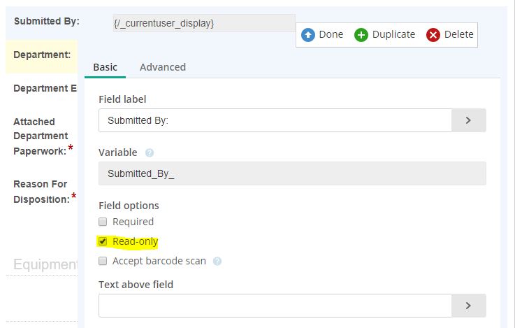

That's odd. Where exactly did you set it to be read-only?

replied on November 28, 2018
I set it to be read only in the field options.
As for the monitoring, the variable is actually blank.

You have to uncheck the 'readonly' on the field itself as well.

The catch with using the Layout's read-only is that you have to remove both the "readonly" and "backend-readonly" attributes because the layout setting adds both of those instead of just readonly.
