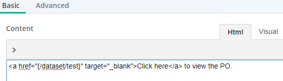

I am developing a small proof of concept and am a little stumped on this one.  I have an HTML field on a Form.  All it contains is an href to another field on the Form (the "test" field).
The "test" field is a hidden field on the the Form that contains the search URL to go find the document in Laserfiche.
The full URL is as follows:
http://localhost/laserfiche/index.aspx?db=Repository#view=search;search={[Purchase Order]:[Purchase Order Number]="818661"} & {LF:LOOKIN="repository\~In Process\~Open Purchase Orders"}
This works fine if I paste it into a browser.
However, when clicking the HTML link it seems to just go back to the page.
When hovering over the href in the form I see the following:
This is a starting form and that is the URL of the starting Form.  Why would the HTML link show the URL for the form I am on and not the URL I have in my Test field?

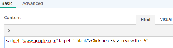

I tried encoding the whole thing and it still didn't work.  But as above I just tried to put the URL in for Google.
So this is now all the HTML is:

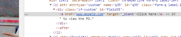

<a href="www.google.com" target="_blank">Click here</a> to view the PO.
Inspecting the page gets me:

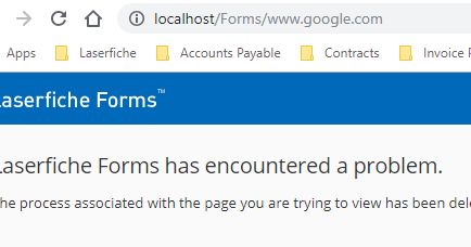

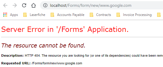

Clicking the link goes to:
Again it is like Forms is trying to append the URL I am currently on before the URL in the HTML link.   In this case I started it from the Process Diagram so it throws the /new in there.
If I go straight to the published form URL:  localhost/forms/invverify
and then click the link it takes me here.
Again it seems to be appending the current URL in there and it's extremely strange.
