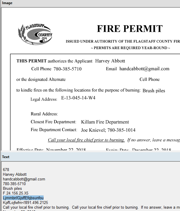

Have you ever seen the OCR process pick up the text on some lines right and then pick up other text on other lines wrong?  In my example this always happens on the same workflow created document, which WF turns into a pdf and then stores in LF.  It picks up the same lines right and the same lines wrong each time.  The lines it gets wrong are interesting:  It changes what it picks up and adds one number or letter up
Example:
  • The image shows 780-384-1014
  • The OCR shows    891.496.2125  (notice how the 7 became an 8; the 8 became a 9?
  • and for the letters
  • The image shows Fire Department
  • The OCR shows   Gjsf!Efqbsunfou (notice how the F becomes a G, which is the next letter in the alphabet; then the i in Fire becomes a j; etc., etc.)
What would cause this?  Note, the OCR process also doesn't pick up the first inch of the top of the page.

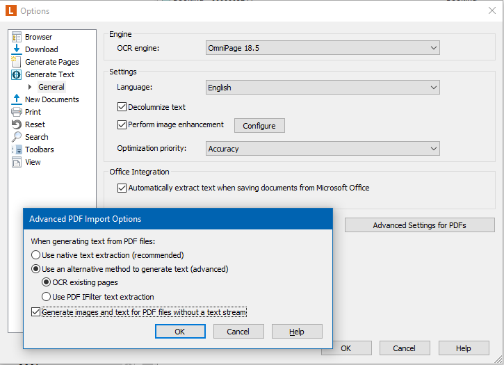

If the PDF is an image, I don't have a ready explanation for the behavior that you are seeing. However, if it's generated, you might try changing your settings for generating text from PDFs and see if it makes a difference. How are you bringing the documents in? Are the users importing them directly into the client, or is it Import Agent?
Here are the settings for the desktop client, and they are similar in Import Agent:

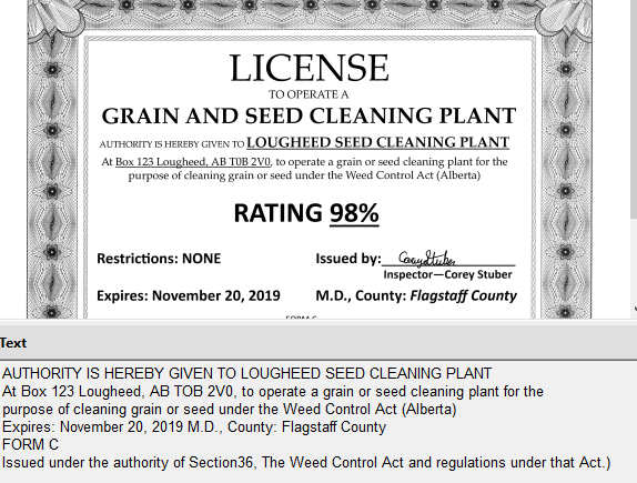

As far as the certificate goes, we've found that the engraving around the edges of certificates tends to mess with things like orientation detection and OCR. You either need to clean them up manually, or run them through Quick Fields so that you can rotate and Zone OCR based just on the center portion.

For the certificates, they are scanned at the photocopier and then brought into Laserfiche via the Import Agent as a tiff.  So, no pdf involved.

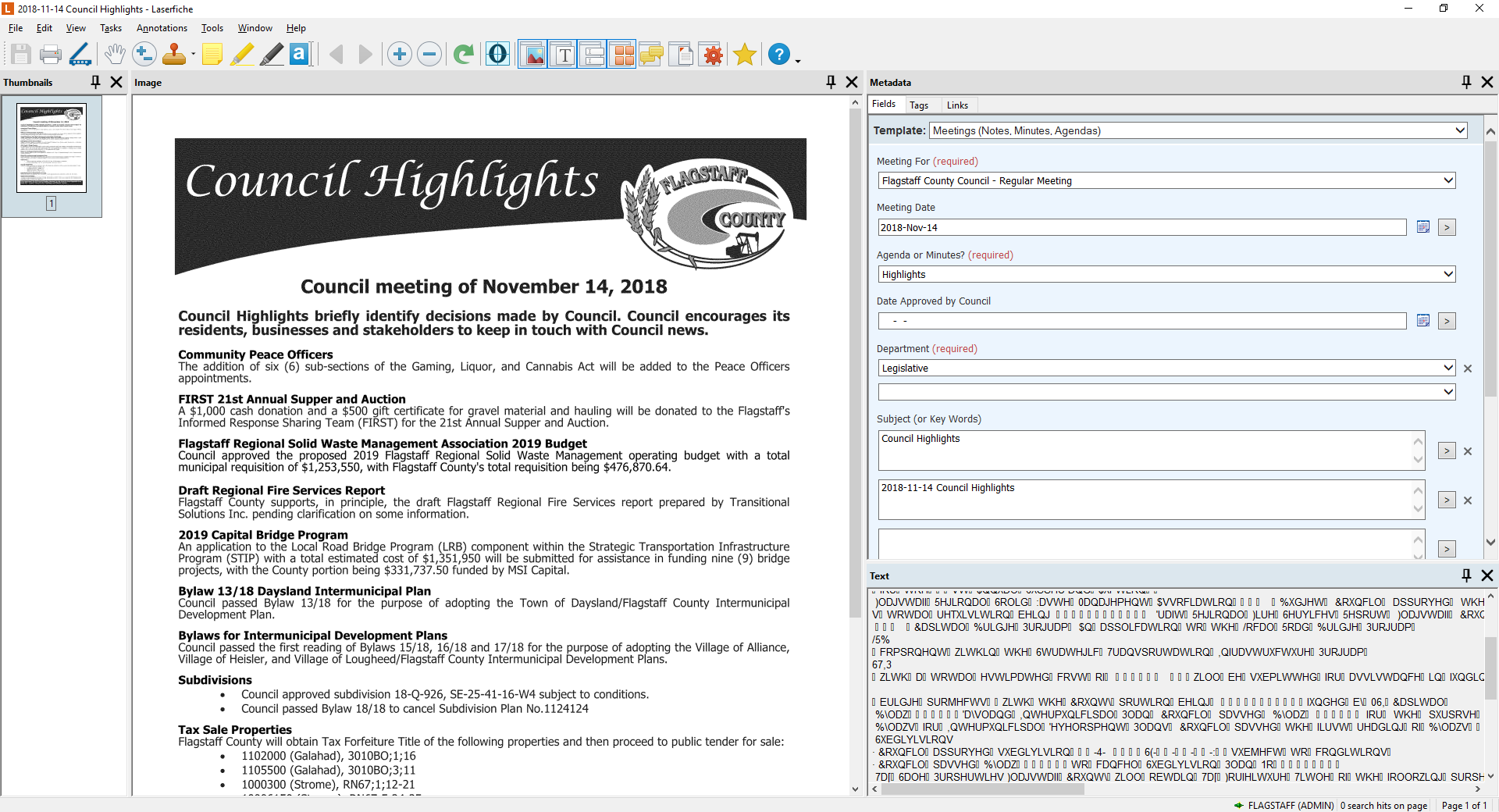

replied on November 23, 2018
We also noticed this one today.  In this example it missed the first inch of the form, but it also missed the very middle, where it says Rating 98% and the line that starts with Restrictions:
This page came in sideways, was rotated, and then the OCR process was manually redone.

Devon, found this one today and we are now testing the settings you pointed out to see if it makes a difference, since it turns out this was a pdf that was drag-n-dropped into Laserfiche:
replied on November 28, 2018
That's an odd one. Are you using the accuracy OCR mode?
Yes, I check everyones' settings when they start here, and whenever I have to set up their Snapshot Printer, I make sure the OCR process in their settings are always set to accuracy.

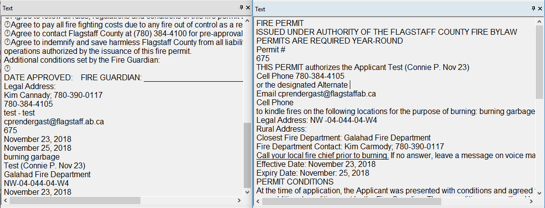

Is it permissible to post some samples of the PDFs that you are having trouble with? I'd like to test in a different environment.
replied on November 29, 2018
Just attached one of the approved fire permits that was just a test document.  This type of document is the one mentioned in my first post.
On the left is the result of generating text with the "Use native text extraction" option set. On the right is with "Use an alternative method to generate text". It looks like what is happening is that the data that was entered is on a separate layer. So it gets extracted separately from the body text. By changing the handling of PDF text, Laserfiche runs a more traditional OCR process, and is able to get correct location data.
Interestingly, if I use a PDF form that I have on hand, Laserfiche doesn't extract the field data at all unless I use the advanced OCR option. If I fill out the form and save as a static PDF, I get the same behavior that you are seeing. The text I filled out is saved on another layer.
