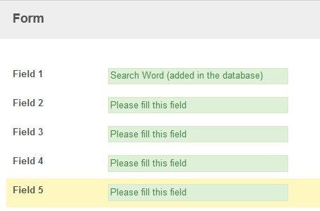

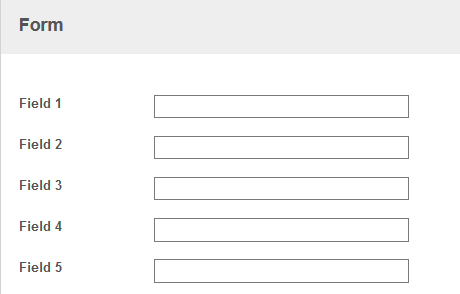

Let me explain. I need to create 1 Search's Form with 5 fields.
My search logical is focus on only 1 field (Field 1 OR Field 2 OR Field 3 OR Field 4 OR Field 5).
I should can not search using all the fields.
When the Form find something, it should populate the other fields.

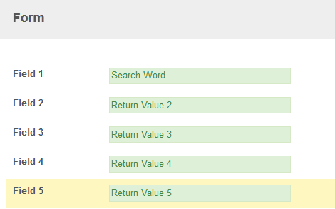

Here, I used the Field 1 to search. If my Form return 1 or more results, then the form populated the fields 2,3,4 and 5 with the first result.

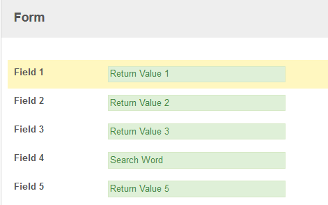

Here, I used the Field 4 to search. If my Form return 1 or more results, then the form populated the fields 1,2,3 and 5 with the first result.
After return, my Form should be a Update Form and no more a Search Form.
In the opposite, of it return no result, the form need to be able to add this new recording in the database then we back to the Update Form.
