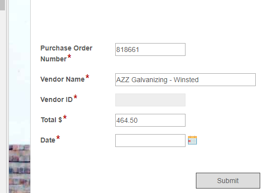

When I click the tab in WebAccess I get the form with everything but the date:

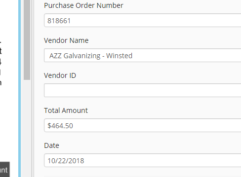

If I enter the actual info in the URL and bypass using the tokens in the custom tab interface:
http://localhost/forms/poverify?vendorname=AZZ Galvanizing - Winsted&ponum=818661&total=464.50&entryid=123&date=10/22/2018
It seems to work.

I played around with this a little bit and think it has to do with the date formatting. If you map a metadata date field into a Forms single line field, you see the format of the metadata field is 2018/11/16 00:00:00. By default, the Form date fields have the format M/d/yyyy, so the metadata date field isn't going in properly. I changed the Form date field format to yyyy-MM-dd, and that transferred the metadata value successfully.
As a workaround, I'd suggest changing the Form date field to yyyy-MM-dd and see if that works for you. We'll look into improving this experience.

http://localhost/forms/poverify?vendorname=Amazon - Business Account&ponum=818673&total=348.48&date=2018/10/23 00:00:00&entryid=45834
So it seems that WebAccess is turning the format of the date field on the template (which is just the standard short date field in the admin console) into a totally different format including time in a URL (which is certainly not what we want).
I did change the field format on the form to yyyy-mm-dd and it did successfully pass it but none of our clients reference dates in this format.  Maybe will have to pass to a hidden field and use JS to move it to a normal date or something.
