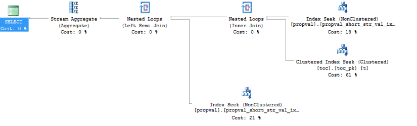

The SQL query plan for that query looked something like this where it was seeking an index that was not optimum for the ~430million records in the propval table:
Ryan dropped the stock LF index and recreated it with a better density order and then created a new index to optimize the two subqueries:

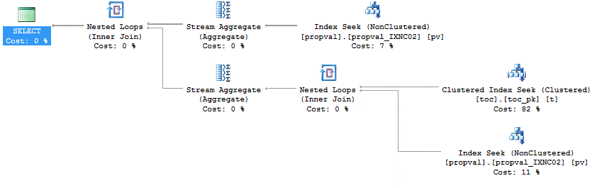

This resulted in a new query plan:
I realize we now have a non-standard index as part of our Laserfiche database. Please advise if anyone sees any issues with this.
