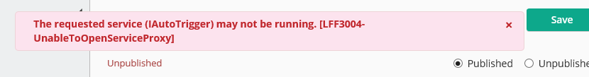

After struggling to get Forms working and having assistance from LF support, we finally are able to log into forms, but submissions do not show up in the history or the repository.  When I tried to create a simple demo form, upon publishing, I get the "The requested service (iAutoTrigger) may not be running. [LFF3004-UnableToOpenServiceProxy]" error.
Any suggestions on how to resolve this new issue?

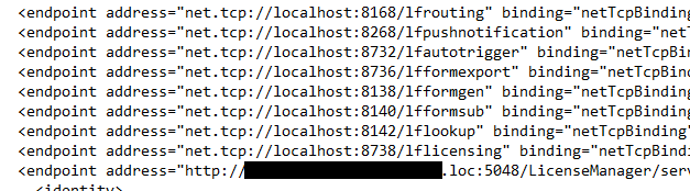

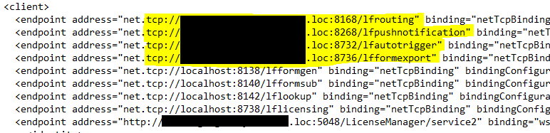

I have been through that paper about 50 times before, and you also went through the config files.
The Forms Web.config on server in the DMZ:
All of the highlighted ports are reachable using telnet.
Forms Web.config on internal server
